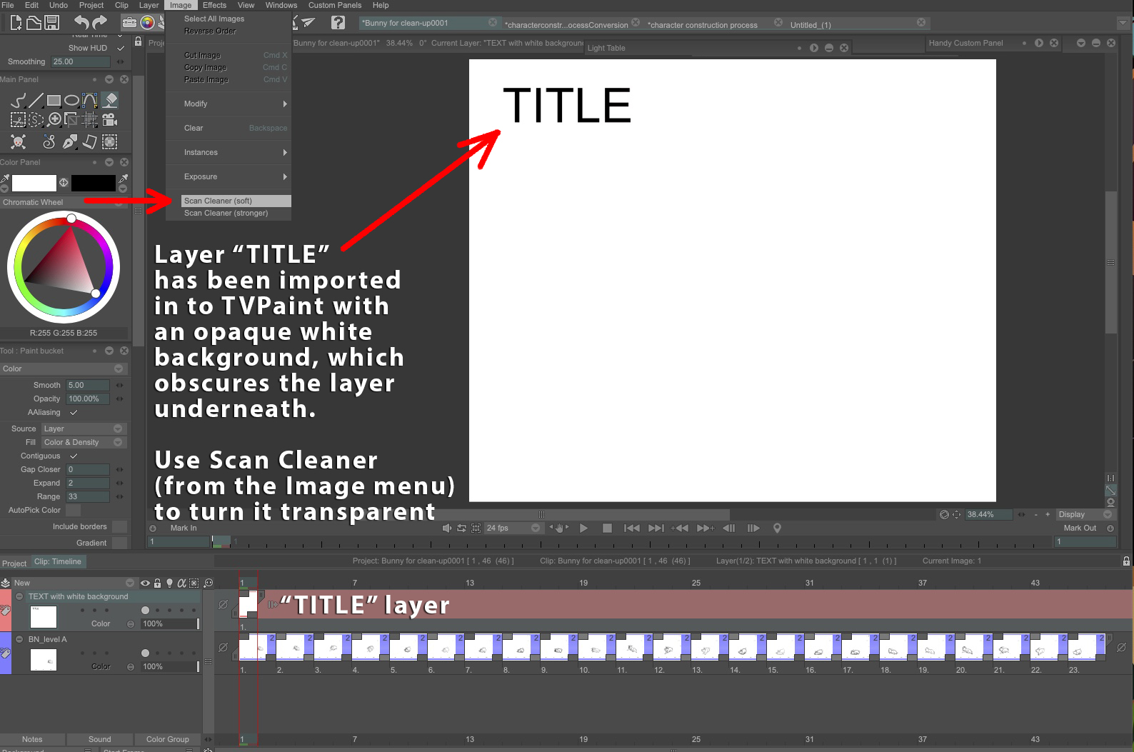

If you imported your original Title with black text on a (opaque) white background, it will obscure anything underneath it and you won't be able to color the black text.
(click on any image to see it larger)

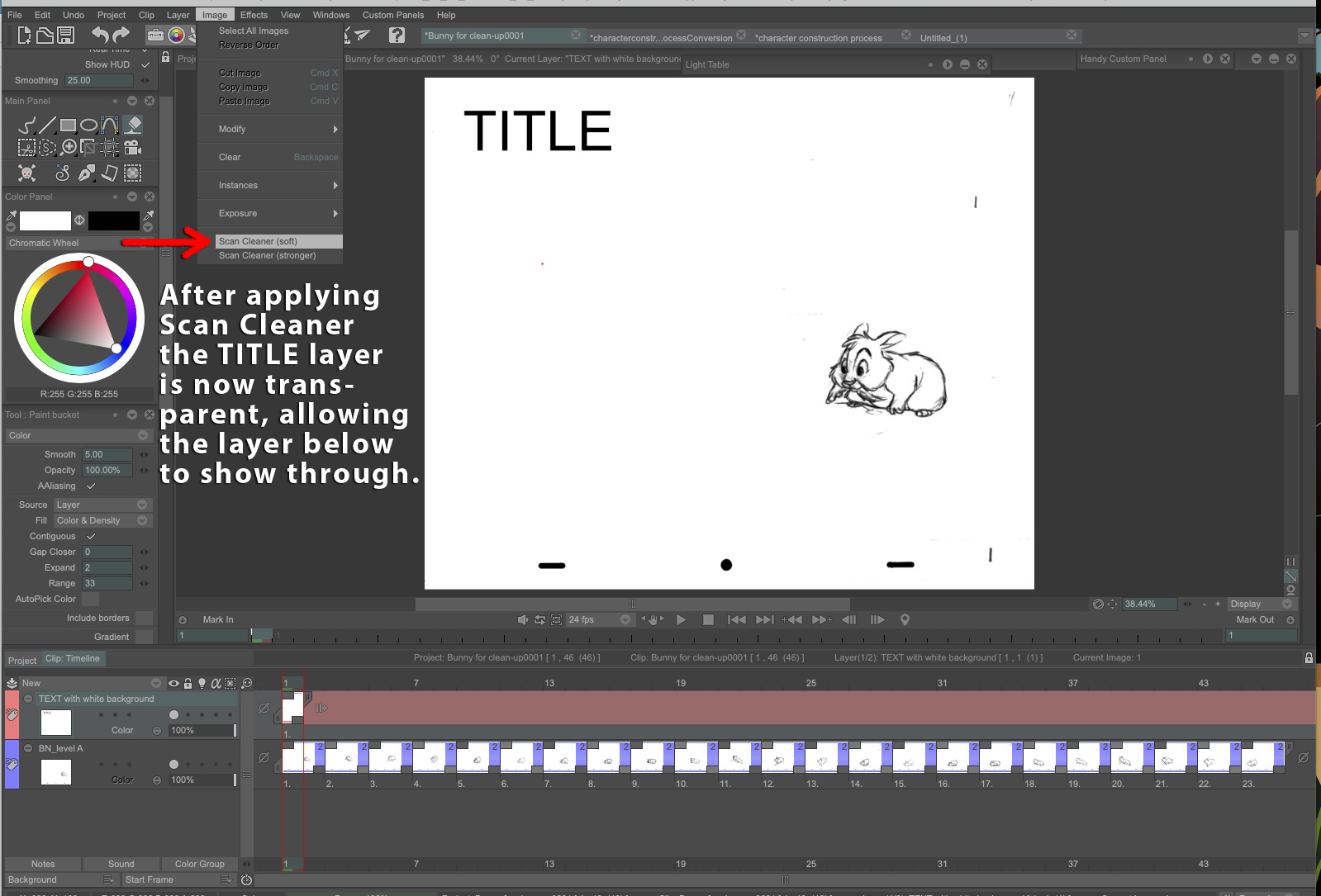

So, you should apply the Scan Cleaner FX to the black text to make it transparent and allow you to color the black text .

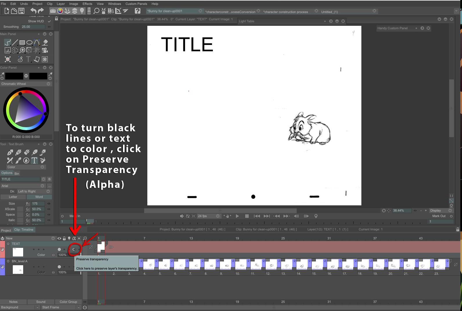

After applying Scan Cleaner, click underneath the Alpha symbol ⍺ to Preserve (lock) Transparency on the layer -

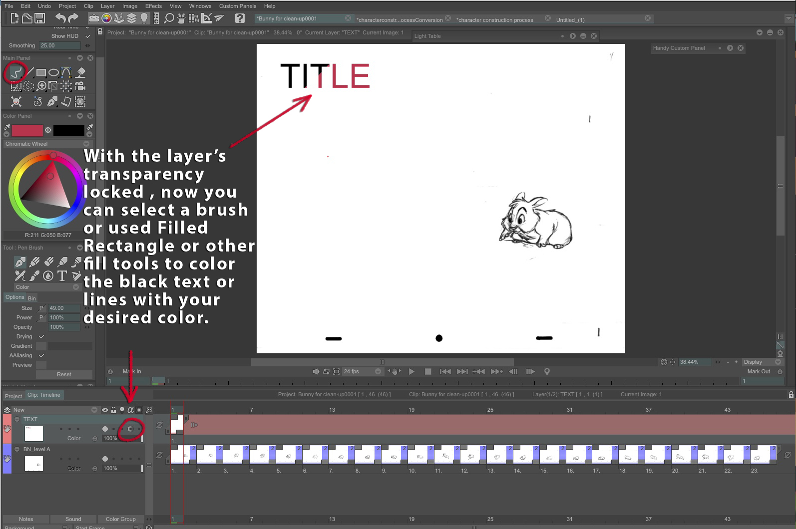

With Transparency locked you can now color the black text (or lines as the case may be) on the layer.

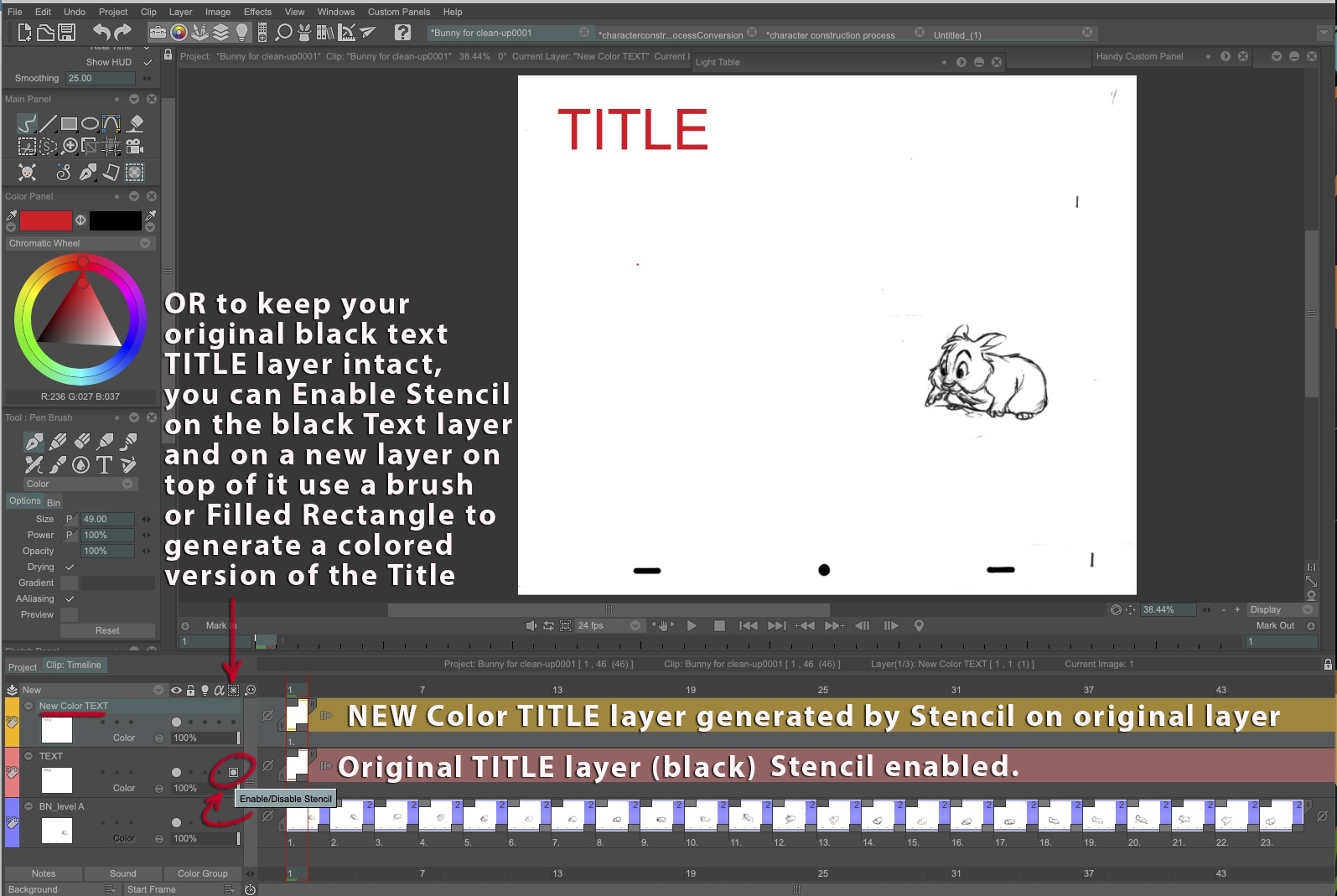

Also, if you wanted to preserve your original Title with the black text, you could enable the Stencil on that layer and then on a new layer on top of it use a brush or fill tool to generate a new color version of the text (a "mask") over top of the original black text layer:
