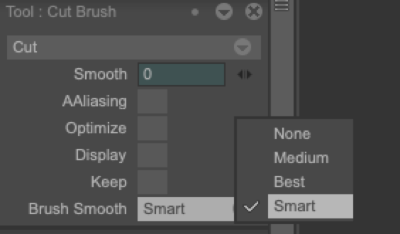

I am working both on Mac and Windows. What a surprise was to discover that since TVPaint 11.7.3 on Windows the AAliasing>Smart option is gone, but on the Mac version it still exists! It is also gone completely from the Beta 12 version both on Mac and on Windows. Since this refers also to TVP 11.7.3 I will repeat this issue here too. Please bring the Smart option back on both versions and please do not take it away - this option is essential to any normal workflow!

Hello Soom, this is likely just a naming error and the Anti-aliasing modes still work the same in v11. We will take a look into this.
Now, without revealing too much because this part of the forum is dedicated to v11 exclusively, the changes we brought to AA in the upcoming v12 made the presence of the "Smart" mode irrelevant.
Experienced users like you know too well that even using "smart" AA in v11 won't prevent your drawings from deterioting when doing certain transformations.
Also, your post was edited to remove the v12 beta screenshot it contained, please avoid doing this in the future.

Hi Dean - I am sure this was a screenshot from TVPaint 11.7.3 on Windows, not Tvpaint 12. Sorry for mentioning TVP12, I won't do that again - I only mentioned it to show the consistency of this overlook.Dean wrote: ↑05 Apr 2024, 08:44 Hello Soom, this is likely just a naming error and the Anti-aliasing modes still work the same in v11. We will take a look into this.
The answer about the irrelevance of Smart option is given by Peter - this is exactly what I mean: Smart was not about high quality, but it was an algorithm that could decide if to apply None in case of no scaling or rotation was done, or High in case rotation or scaling was done.

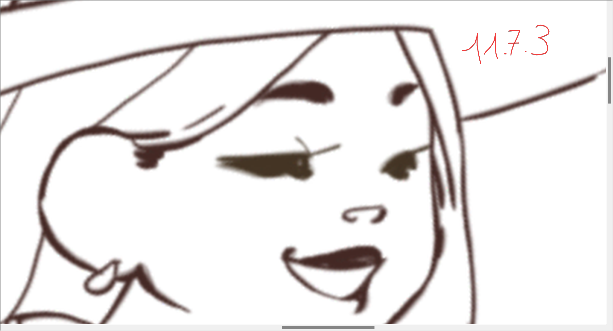

No code linked to AA was touched for v11.7.3 and I just did a quick test in both 11.7.1 and 11.7.3 to check if line decay is the same between them, I used 5 rotations of 72 degrees (attached screenshots).
