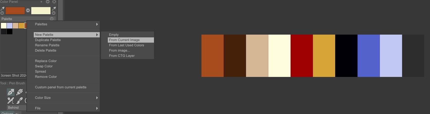

There's a way if you import the picture of the palette.
Open the Color Panel, choose Palette in the menu, right click to open menu then "New Palette > From Current Image"
You'll have all the colors but the order won't be the same (from light to dark)...

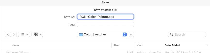

Peter Wassink wrote: 29 May 2024, 12:22 What are "swatches" is that a photoshop file format for a palette?
Yes, a swatches group (palette) can be exported from Photoshop as an .aco file.
There may be other applications that can import .aco file (I think Clip Studio Paint can do it). I believe that is what he is asking for in TVPaint.

As suggested by mox, you could take a screenshot of the swatch panel in Photoshop, then import to TVPaint and Open the Color Panel, choose Palette in the menu, right click to open menu then "New Palette > From Current Image" .
Using an online app like ACO File Viewer https://aco-viewer.appspot.com you can open an .aco file to get a nice large image of the swatch panel (then take a screenshot of that and import to TVPaint)
