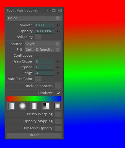

Gradient works best and most obviously in cases where you fill a surface.
for instance with paintbucket, filled rectangle or filled stroke.
using this panel:
You can, in some cases, also use gradient in line drawing tools but not with all brush types.
for instance
an airbrush with reduced opacity shows it well even without pressure sensitiv input: the penbrush gives you this: but you do need pressure sensitivity
using this panel:
