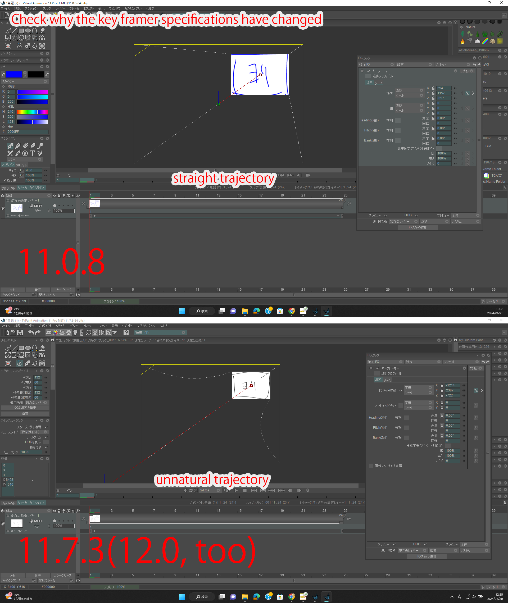

Have the specifications of KeyFramer FX changed?
I received a message from a user in Japan saying that the specifications of KeyFramer FX have changed since before,
and I checked it out. Indeed, even if you hit the same key in two places, the trajectory is different.
In many cases, a straighter trajectory is preferable, but do you know why?

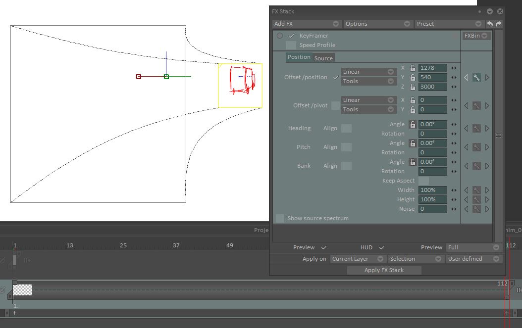

z-camera is set to 1000:
i removed my explanation there because when i tried it out myself it acted as Hironori described
and not as i remember TVPaint doing it before.
Unless there is some logical reason for this behaviour that i missed, i consider it a bug that should be fixed.
viewtopic.php?t=16476

- Posts: 4518
Re: Have the specifications of KeyFramer FX changed?
I don't fully understand your explanation.s.decol wrote: ↑21 Jun 2024, 14:00 It's not a bug, but more a side effect due to the fact that now transformations of the keyframer are applied from the pivot point. So if you want to make the movement like in 11.7.0 or lower versions, you have to move your pivot point in order to make it stay always at the same place in the space of the drawing area between two keys (as the coordinates of the pivot point are relative to the coordinates of the center). Maybe we could add an option to let the user choose whether the coordinates of the pivot should be relative to the center or should be "global".
i could not make it work in a straight line!?
Did i miss something and can you explain how i would achieve a straight motion in the above example?
I hope you can, but i'm afraid the Offset Pivot solution needs to be looked at again.
Because what is clear is the current behaviour is very disorienting, to the point of rendering the z-function useless.

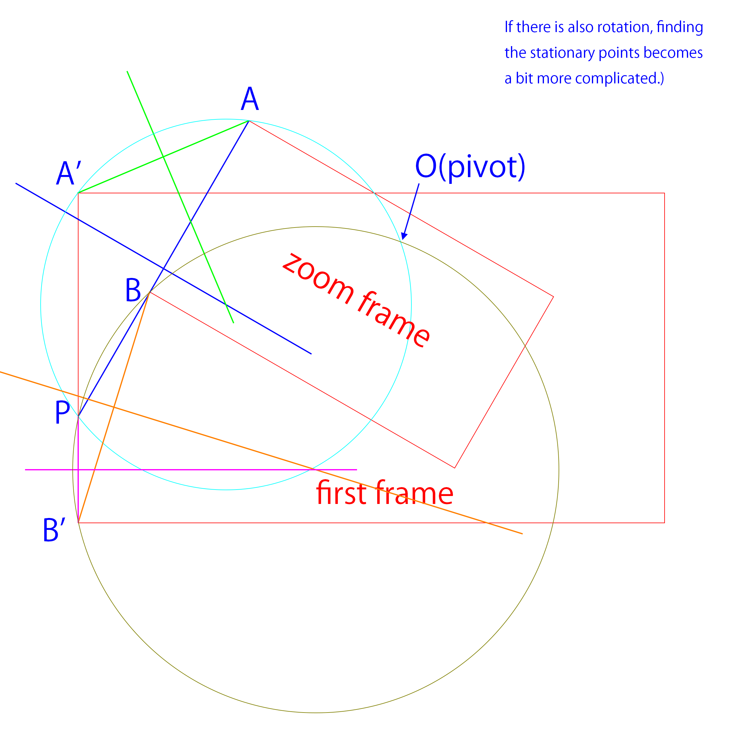

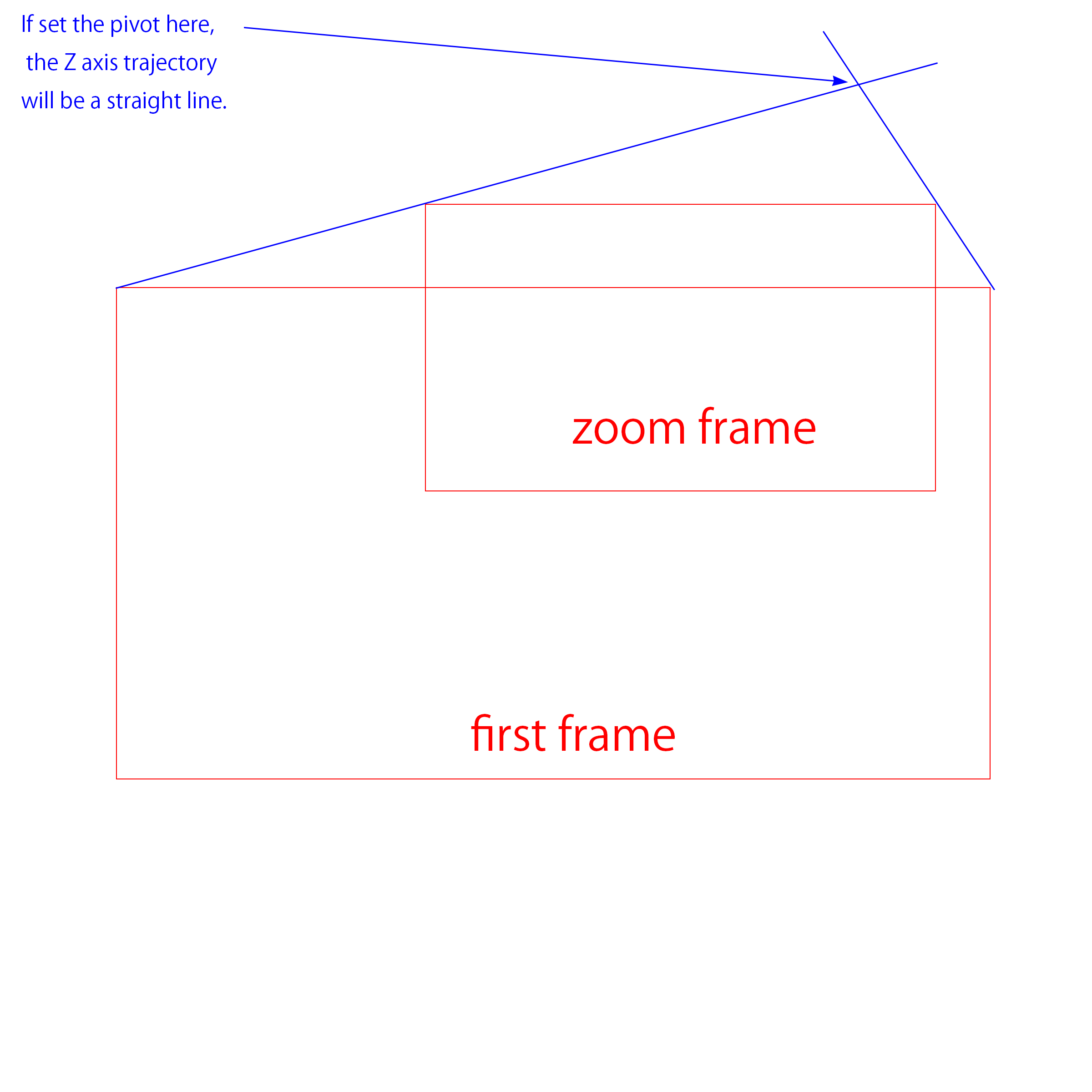

- Hironori Takagi
- Posts: 326
- Joined: 14 May 2018, 10:15
- Location: Tokyo, Japan
I created this diagram to help artists, not programmers, understand a little better. I hope it will be helpful.Peter Wassink wrote: ↑24 Jun 2024, 06:51how?Hironori Takagi wrote: ↑24 Jun 2024, 01:46
I understand how to calculate the pivot point and set it to a position that does not move,
but I think it is a bit difficult to explain the same method to someone who is not interested in programming and mathematics.
as a veteran tvpaint/keyframer user i have no idea how to do it. and i really tried it.
Keyframer is broken

- Posts: 4518
Thank you Hironori!
That helps. (although that second image is not easy to decipher)
I would also like an option for the old pivot
