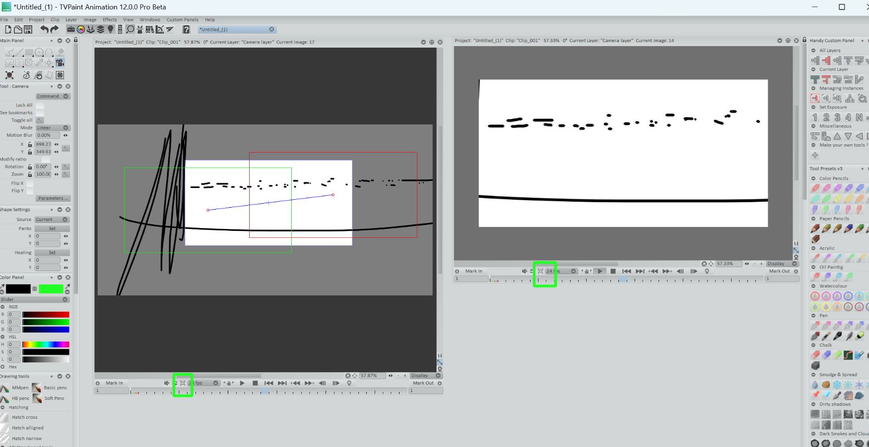

you mean this?:

i forgot to mention so maybe it was not clear... what you see in the image are two windows of the same project
you can (theoraticly) have an endless number of windows open, use shortcut 'm'

You can create a new project view with "M" as mentionned by Peter, but unfortunatelly, it is not possible to move this windows outside the interface because the Main window of TVPaint is the Project window, even if you have 2 projects windows at the same time.
By the way, it is currently not possible to have one window in Project view and one window in Camera View of your current project during the Preview. Both windows are synchronized.
It has been added to our feedback list, we will see what can be done in the future version !
