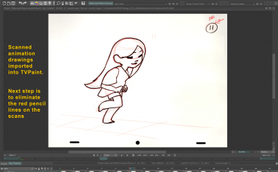

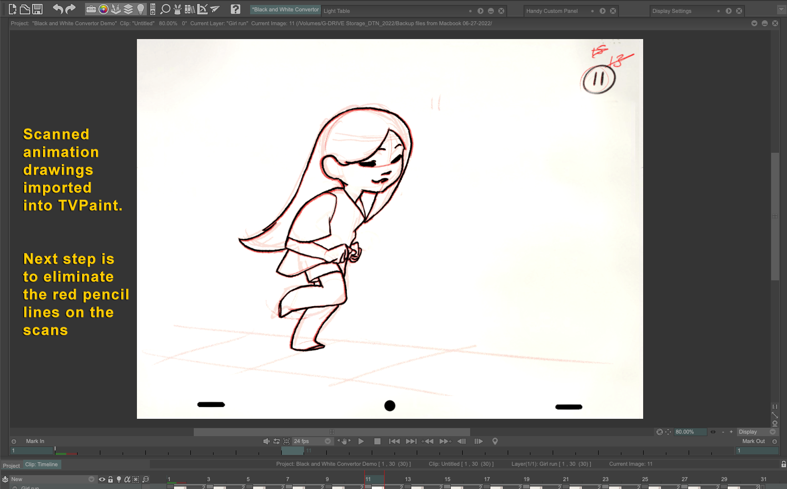

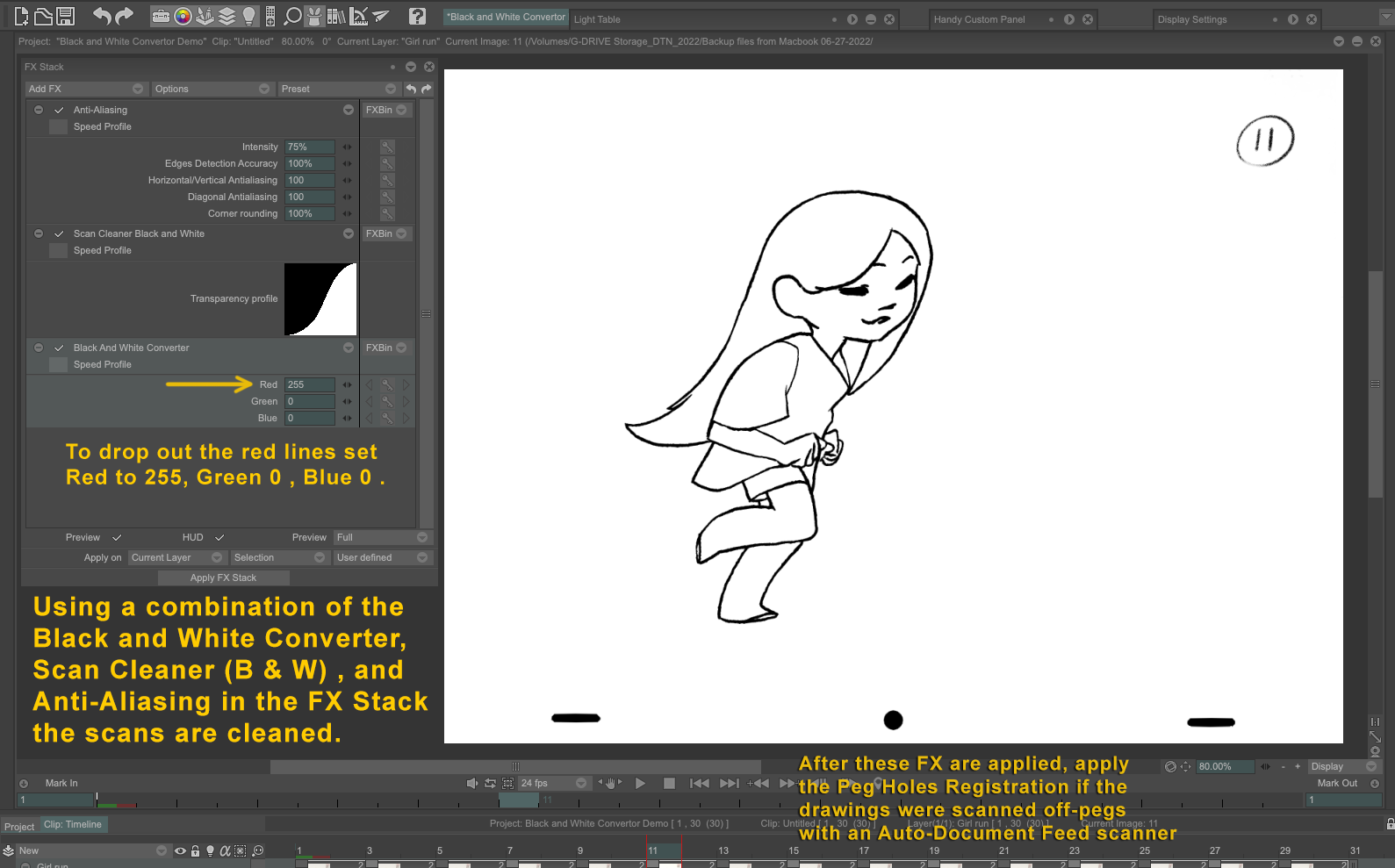

Let us say the user has drawn their animation on paper , using red pencil as the underdrawing for construction of the rough drawing, then knocking down the red lines using a kneaded eraser, cleaning-up on top of the red pencil lines with black pencil. When the drawings are scanned if a red channel filter is not used during the scanning , then the red lines will need to be removed when the drawings are imported into TVPaint.

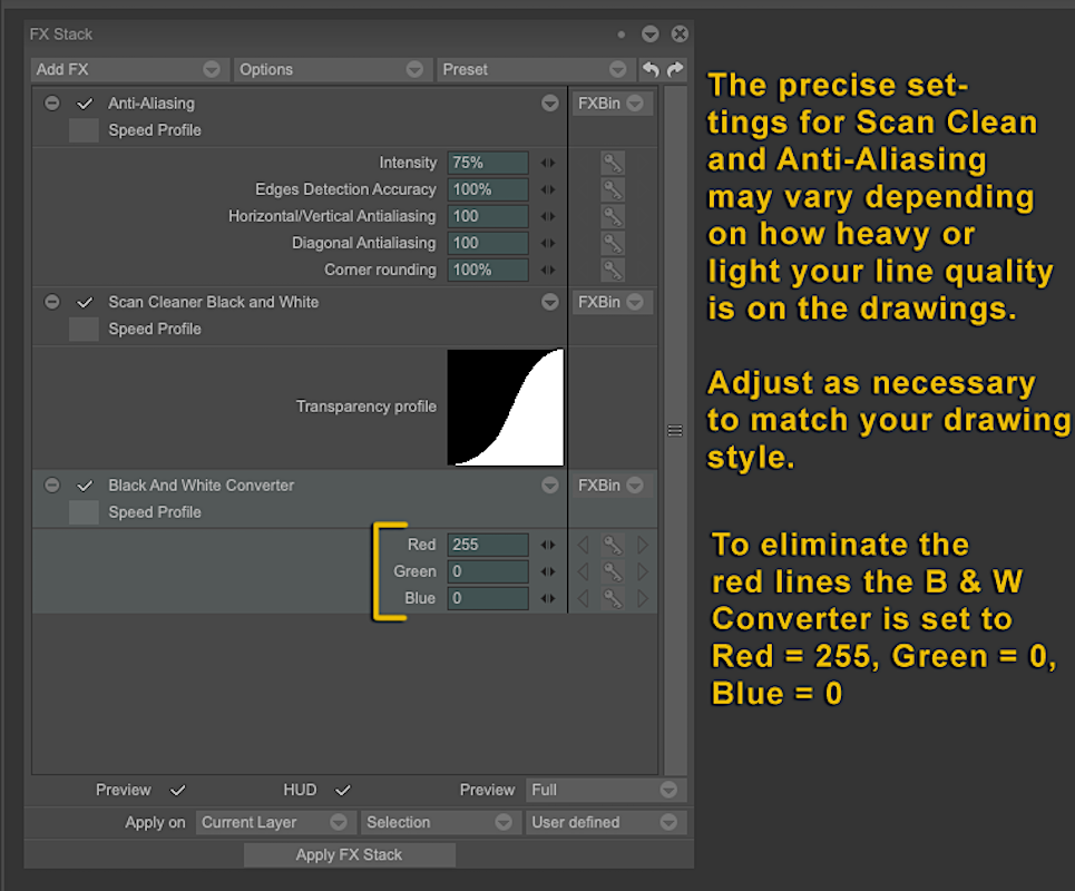

This is easily accomplished by using the Black and White Converter (along with a combination of the Scan Cleaner Black and White , and optionally the Anti-Aliasing in the FX Stack).
click the images to view them full size
(for the demonstration I used the girl from "Journey Through Creativity")
(obviously, if the colored pencil lines are blue pencil or green pencil, use the blue or green channel set to 255
and the other two channels set to 0)
I was reminded of the need to add this explanation to the User Guide because I had the experience of explaining this process to an associate who was new to TVPaint and was unaware that this function was possible in TVPaint , so he was laboriously importing all his scanned drawings to Photoshop first ,creating a Photoshop Action to remove the red channel , then importing the drawings into TVPaint for Scan Cleaning , Peg Hole Registration, and Coloring. When I showed him there was no need to go through Photoshop first, he could do all of this easily in TVPaint, he was very happy to know about it , but remarked that he would never have understood he could remove the red lines (or blue lines , or green lines) from reading the section on the Black and White Converter in the User Guide. There is a perception among some people that TVPaint tends to "hide" information from the user that could be presented in a clear, upfront manner, instead of assuming that another more experienced user will enlighten the new user or that the new user may accidentally stumble upon the information themselves by trial & error.

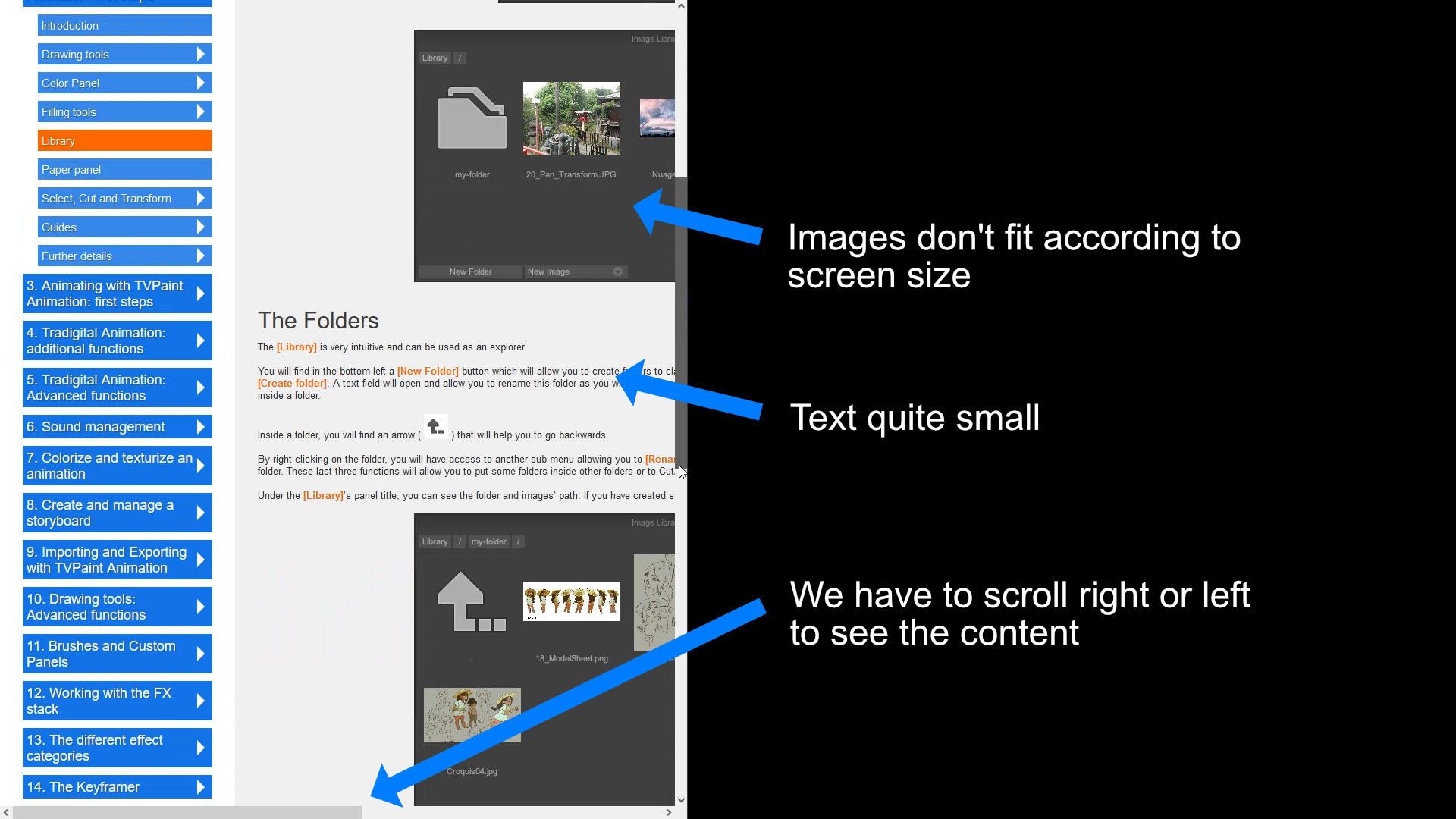

I may have suggestions regarding the display of the documentation, to make it more adaptable to screen sizes (specially small screens) and subsequently maybe more practical to consult.
My suggestions would be:
  • a bigger font
  • the main body text of the documentation to adapt to smaller screens
  • the images to also adapt to smaller screens
here is an example of how it could look like:
Documentation responsive design.mp4
(15.59 MiB) Downloaded 2258 times
this is how it looks at the moment:
Also, when on smaller screens, the main menu could maybe be in the form of a so called 'Hamburger menu', for example. Here is somebody's demonstration of a Hamburger menu.
Toon Boom's documentation on a small screen has the main menu sliding from the side, with each sub sections also sliding from the side, taking over the previous menu. It makes it still practical to navigate a large menu.
It's the same idea with Open Toonz's documentation or Krita's documentation, for example.

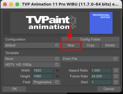

On this page in the user guide: https://www.tvpaint.com/doc/tvp11/index ... nces-start
To make a new config the user guide says:
* To create a new configuration, click on the Create button of the Startup Panel. A text window will then pop up for you to name this new configuration.
But there is no button called "Create" in the Startup Panel. The button to make a new configuration is "New".
Make New config.png (29.91 KiB) Viewed 65606 times
Posts: 2815
Re: Mistakes in the user guide
Good catch!
I have fixed it. It should be reflected when the cache clears itself.
