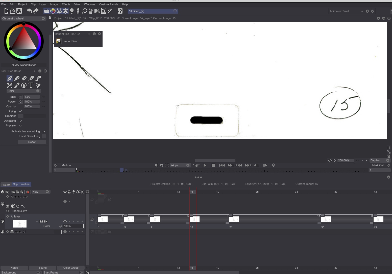

This panel by Hironori Takagi actually imports image sequences with gaps and puts it onto one layer:
Here is the original post: viewtopic.php?p=117181#p117181

But the panel will place the imported images to their corresponding frame on the timeline (as intended) if, before the number, there is either:
Here is a demonstration of the panel:Hironori Takagi wrote: ↑22 Jan 2020, 06:18 I rewrote a part of the ImportFolder script and tried to make it a panel.
Please check it.
ImportFiles_200122.tvpx
EDIT from the 10th of July 2024
It won't place the imported images to their corresponding frame on the timeline if there is a period before the number in the file name (ex: MyAnimation.002.png).Hironori Takagi wrote: ↑10 Jul 2024, 02:42 This import sample is not a good example because there is a period before the number.
- a hyphen (ex: MyAnimation-002.png)
- an underscore (ex: MyAnimation_002.png)
- nothing (ex: MyAnimation002.png)
As far as I remember, if there wasn't a period before the number, the ImportFiles were placed at the appropriate number on the timeline.
(This is a good example of artists doing things that engineers wouldn't expect.)

Indeed!Hironori Takagi wrote: ↑10 Jul 2024, 02:42 This import sample is not a good example because there is a period before the number.
It works fine when, before the number, there is either:
Re: Import image sequences with gaps on one layer
This is good to know it is working for you now. I did not notice in the screenshot in your original post that there was the extra . before the number.Jeremy Richard wrote: ↑10 Jul 2024, 10:56Indeed!Hironori Takagi wrote: ↑10 Jul 2024, 02:42 This import sample is not a good example because there is a period before the number.
It works fine when, before the number, there is either:Thank you Hironori for sharing this panel.
