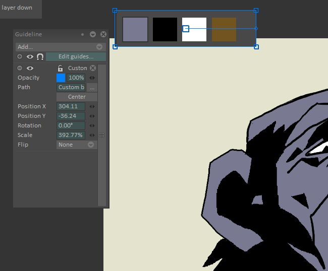

two alternatives for this, that have the advantage you can place them anywhere in the interface.:
(both still need switching to colorpicking mode to get the color)
- a custompanel with actions that only contain the A-color
position stays relative to the interface
- a guideline image
position stays relative to the project
guideline colorpalette.jpg (27.94 KiB) Viewed 3801 times

Aaaah, clever, thank you! I think I should be able to try figure out both of these solutions. Thanks Peter!

Just wanted to say thanks, Peter - I created a custom panel and it's a great solution.
