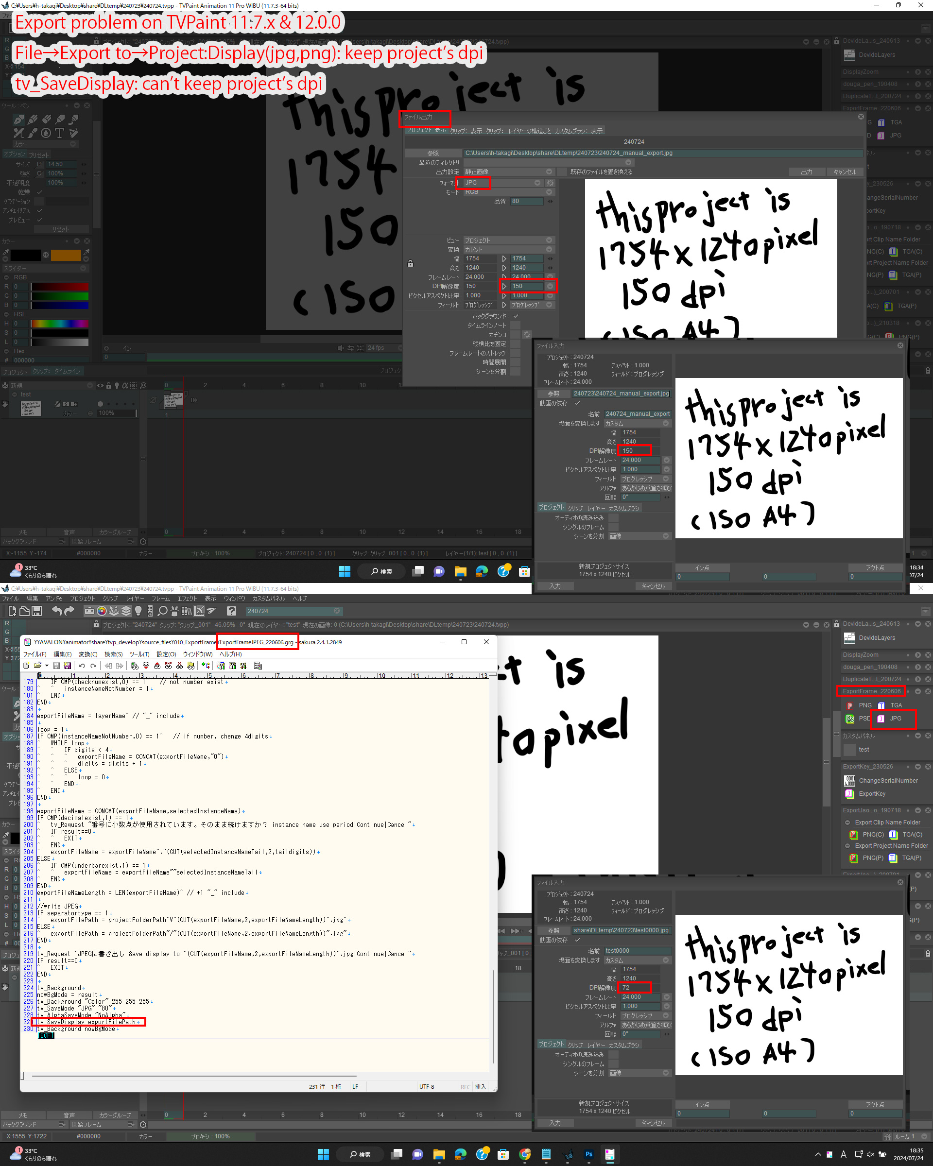

I found difference of "Export to Project: Display" and "tv_SaveDisplay" george command.
Is it possible to resolve the issue of dpi not being reflected by the "tv_SaveDisplay" george command?

The attached image is a pointing out that when you run File > Export from the same project (150dpi),
the dpi is preserved (150dpi), but when you output the result with tv_SaveDisplay, the dpi is not preserved (not set).
By the way, with tv_ClipSaveStructure, the project resolution is preserved for jpeg and png,
but not for psd and tiff, which can actually record dpi, so I feel like this could cause trouble for users.
(I'm sure another user has pointed this out in the past)
Re: Difference of "Export to Project: Display" and "tv_SaveDisplay" george command
Hello Hironori Takagi,
Indeed, there is something we have to investigate, our devs will look at it as soon as possible.
