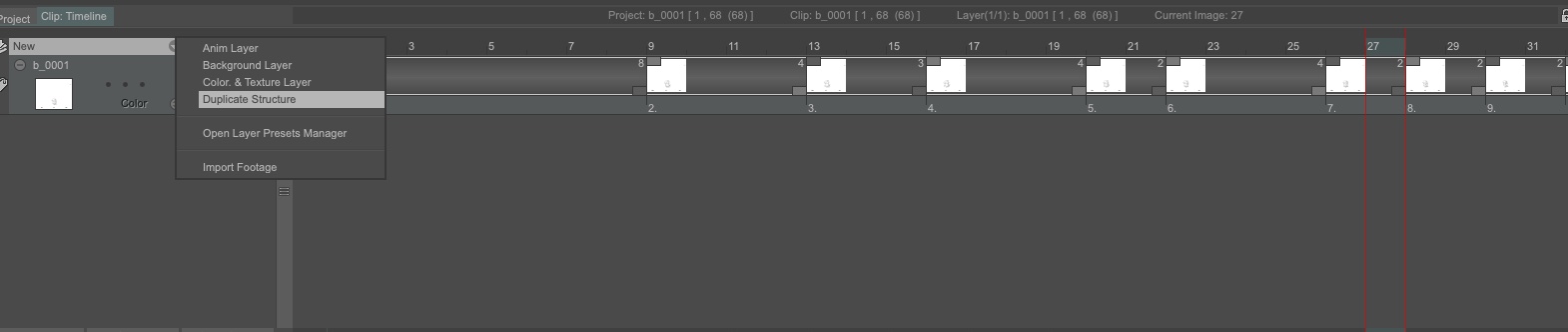

As it is now , we can Copy an image from outside TVPaint , then from Edit Menu > Clipboard we can paste the image from clipboard to TVPaint, but it pastes the image to a New Layer. We need option of Paste & Replace Image on Current Layer.
AnimationDog wrote: 07 Aug 2024, 16:12

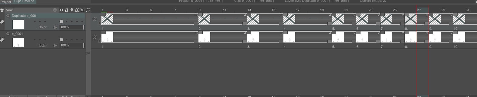

Also, copying the timing from one layer and applying it to another layer with the same number of instances.
I'm not sure if this is what you want , but if you select your current layer , then go to NEW and select Duplicate Structure it will create a new blank layer with the same number of instances and the same timing.

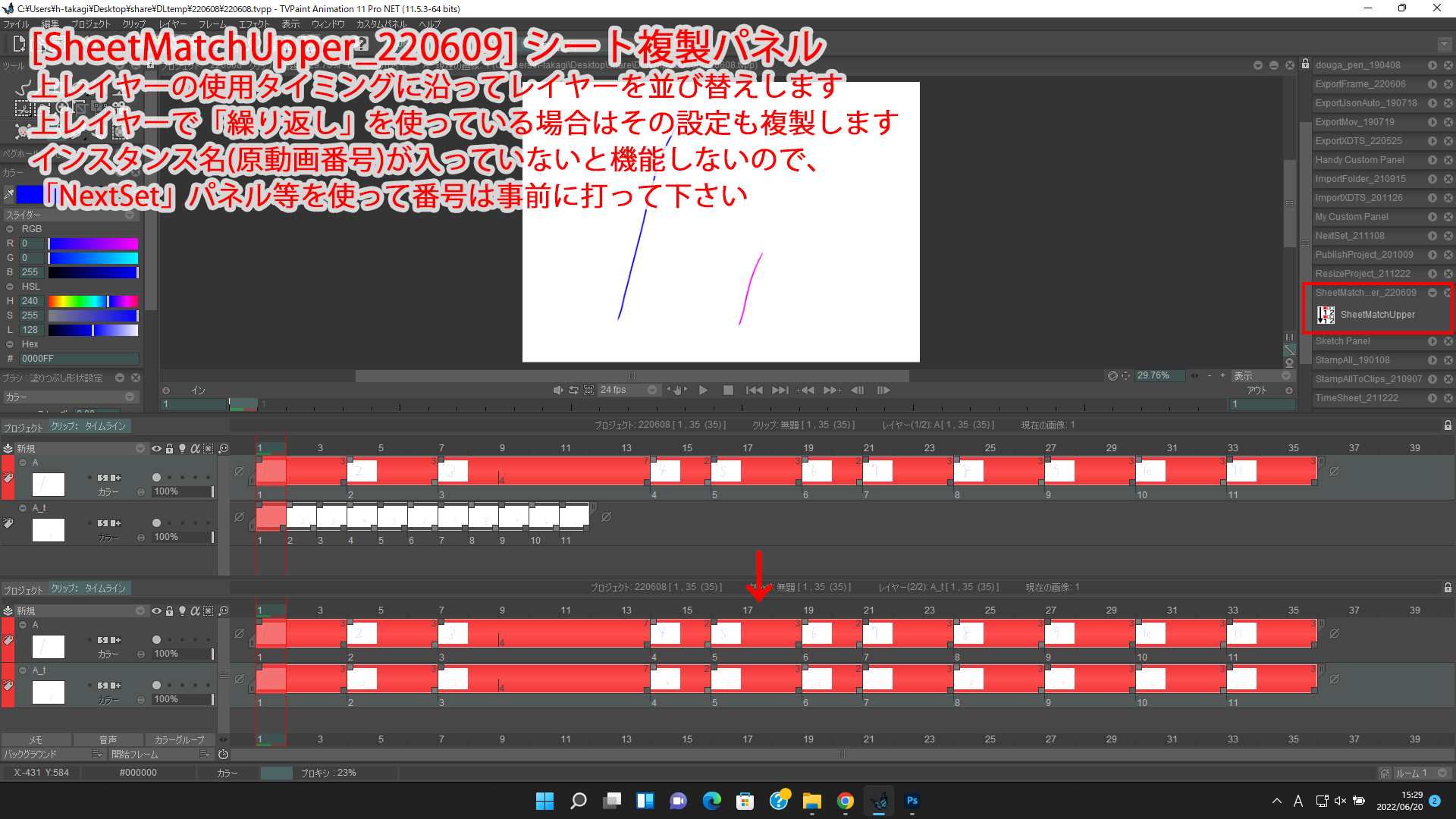

I have previously distributed a panel like the one below at a Japanese user forum.
・SheetMatchUpper
I'm sorry that the explanation is in Japanese, but I think you can get the meaning from just the images.
SheetMatchUpper_220609.tvpx
