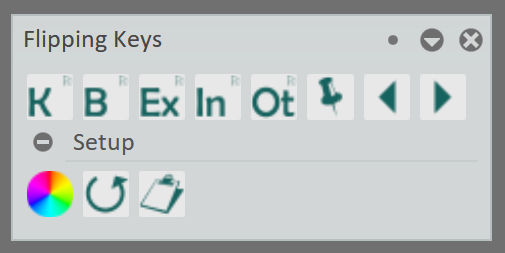

Hello, here are a couple of custom panels I've developed and explanation of what they do/how to use them.
PLEASE NOTE: These were made for TVPAINT 12, and while I've tested them on the demo version of 11.7.3, and they function fine there I have not tested them as thoroughly. Also, I am new to scripting, and only after trying one final time did I make some headway with GEORGE. I've tried to debug these panels/scripts as much as I can testing it out myself. They should work fine, but they do use a loop, and it's possible I missed some variable that might cause it to misfire. If after installing them, you end up having an issue where it seems like TVPAINT is frozen, please hold the ESCAPE key for a second or two, if there is some issue with the code being stuck in a loop or executing it will cancel the script out.
(I had posted an earlier version in another thread in the George scripting subforum, this version gets rid of some bugs I discovered, changed the way some of the code was built, more features etc. etc. I will call this version v1.0 as the other thread was mostly to show Sven what I had been thinking of and had gotten to work somewhat)
Flip Keyboard Toggle
The idea behind this panel is some similar functionality to Harmony as discussed in this thread: https://forum.tvpaint.com/viewtopic.php ... 17#p124917
Basically, I want to have two buttons on my keyboard set as shortcuts to move backward/forward along the timeline, with the ability to toggle on/off options for which images those shortcuts go to, and that's in short what this panel does.
**note These panels makes use of writing/reading to the config file under the head [kcustom]. It shouldn't cause any problems in the config, but If you want remove the panel and any remove traces of it, go into the config.ini file in the AppData\Roaming\TVPaint\Confignamehere and open it in a text editor and delete the portion underneath [kcustom].
Parts of the Custom Panel

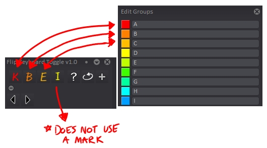

1. Backward/Forward Keys > First thing is you will need to set up a shortcut key for going backward and forward along the timeline. I use F and G respectively. Once you have set these shortcuts, you can close the horizontal divider in the custom panel to hide those buttons to make it smaller.
**I would also highly suggest setting a modifier key such as shift or ctrl + the above two buttons to either layer > Go LEFT/RIGHT or layer > Prev/Next IMAGE. This will be explained more later, but because the script only moves between instance heads, these added shortcuts will give you the ability to move through individual exposures to break them etc. I use shift F + G myself.

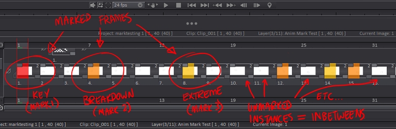

2. K B E I Buttons > These four buttons make up the main portion of the functionality.
Keys, Breakdowns, Extremes and Inbetweens respectively, they will use the first 3 built in Image Marks for Keys, Breakdowns, and Extremes. For Inbetweens, the script does not use an Image Mark, but rather the lack of a Mark to determine which instances should be considered an inbetween.
The way these buttons work is pressing them once will turn that respective flag on, and pressing it again will turn the flag off.
(Just a quick explanation: I don't use extremes in my own workflow, but having an extra flag to work with is useful for a number of reasons. I've put extremes after breakdowns in the "hierarchy order" though technically they would come before in importance: see the discussion in the above linked thread for more discussion about Keys/Extremes etc if you are so inclined. If this is annoying to you, you can just simply swap the icons and use what is the current Breakdown button and MARK 2 for Extremes and vice versa, BUT just be aware in the code underneath the flags are labelled as Mark 2 = BD, Mark 3 = EX and so only change the ICON of the buttons, not the button order or it may break things).
The buttons are color agnostic in the script as the code only checks for the built in number of Mark 1, Mark 2, and Mark 3(labelled A, B, C respectively by default in v12.0.1) So please feel free to recolor and change the icons accordingly, I use different colors myself but thought for demonstration this would be simpler.
(If you are inclined, the code *I think* should be simple enough to add any number of flags/marks you want. If you look at each button and the george scripts that are produced by installing the script, they are documented to explain whats happening. I haven't tried this but it should be not to difficult the way I have it set up)

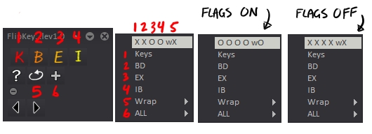

3. Check Button > The check button is super important and should get it's own shortcut. (I use CTRL + F) As TVPaint has no way to tell you if a custom panel button is turned on/off, this is the workaround I am using. Pressing the check button will bring up a menu at your mouse position with the following options.
The numbers show the relationship of the Custom Panel buttons to their respective options in the Menu.
The top row(highlighted in white) is your "Check" portion, which will be how you can quickly reference which Flags are on/off. (note**Choosing this option, cancelling out, or clicking outside the menu will not do anything)
From left to right they correspond with the K, B, E, I, WRAP buttons. An O will mean that flag/button is ON and an X will mean that button/flag is OFF.
The other portions of the drop down menu give you another option of setting flags on/off as if you were clicking the custom panel buttons. WRAP and ALL open sub menu's with ON/OFF and will be explained below.
4.Wrap Menu > This will allow you to set wrap ON/OFF which will cause the script to wrap around and start at the beginning/end of the layer looking for the next image to go to. This acts like the "Loop" function available in the built in Image Mark menu when you use the built in prev/next mark shortcuts, but also works for inbetweens. Wrap will work as soon as you are at the image in a layer where there are no more flags in that direction to continue to.
5.ALL Menu > This will set all flags On/Off.

Setting the script flags for K, B, E, I will cause your shortcut keys(F, G in this example) to skip all images aside from those flagged with their respective Image Mark, or lack thereof for Inbetweens.
These flags operate irrespective of each other, so you can have any combination set on/off and those that are OFF will be skipped.
For a first and simplest example is if you have only K turned on, then F/G will only go between your Red Image Mark(Key) frames.
Another example if you have K & B set, then using F/G will only go backward/forward to images Marked with Red(Keys)/Orange(Breadkdowns).
If you have only I(inbetweens on) all frames that have an Image Mark will be skipped as the script looks then for non-marked frames(this includes ANY marks not just the first 3 in the list).

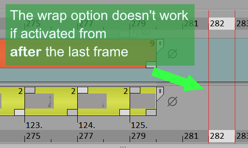

-If wrap is set to OFF, you can proceed outside the start or end of a layer's current images so that adding more instances is easier(this is an improvement over the original script). This is better as it functions like the default behaviour of next/previous instance shortcut to allow easily adding new frames.
-When wrap is on, having shift + F/G which we set up to earlier as layer:next/prev image or layer:go left/right will be the quickest way to move outside the current images to add new frames(You can use mouse or other keyboard shortcuts as well). Wrap will only function WITHIN a layer's images, so if you use your mouse or another shortcut to go outside the current set of images(to an empty frame) and try and press F/G, wrap is automatically turned off and you will proceed frame by frame as normal. If you use the shift F/G key to get outside, then add a new image, Wrap will continue to stay ON.

-If wrap is ON and there is no other flagged images on a layer for the script to go to(such as a layer with a single image), it will give you a warning (both to prevent an infinite loop, and remind you wrap is on and that's why you aren't moving).

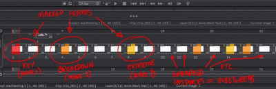

The 3 main buttons function the same as before. If you flag K, B, or E, it is going to change the settings for "FlipsToggle" CHECKPOINTS to Mark1, Mark2, Mark3 as checked respectively. These can be combined and toggled on/off irrespective of each other to skip certain marked frames and not others.
Important to note, anytime you flag one of the Marks, it will automatically turn the IB flag off. If you want to include IBs, you need to turn that one on separately, there is more info below in the IB section regarding how to go through all your instances.
So with all 3 Marks on it will look like this
Now, the major difference between the two panels is how the "I" or Inbetween flag works.
With this panel, flagging the IB ON will change the CHECKPOINTS to INSTANCES (irrespective of if you have any or all marks flagged OFF). This functionality will also allow you to keep your MARK flags set to on, but then while IB is flagged you will go through all instances, and then when you flag off IB's again you will have your Marks still flagged as previously. The other differences between the panels are:

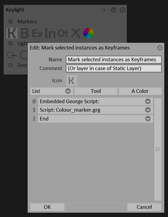

To that effect, at the moment, for my panel, I'm using the following script in combination with some of Lucas' panel buttons:
Then for each marker button I have something like this:
first with a code to "catch" the variable with the set colour
(With the corresponding "id" variable for each button)
Then secondly, a version of Lukas' color_marker.grg script from his Sketch Panel marker buttons.
Feel free to use any of this if you think it can be of any use to you.

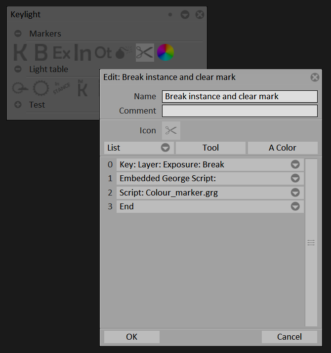

I myself will definitively look at the way you did your "Check" button to improve my "Set colour" button. The O and X references at the top of the menu is a nice touch.
Lately I've been experimenting with the markers' buttons from Lukas Sketch Panel which mark all frames of the instance and not just the head. And so in that case, the forward and backward button of your panel move through all frames and not just on the instance's head, which doesn't seem to be intended. Unless I missed something. I'm using TVPaint 11.7.3.

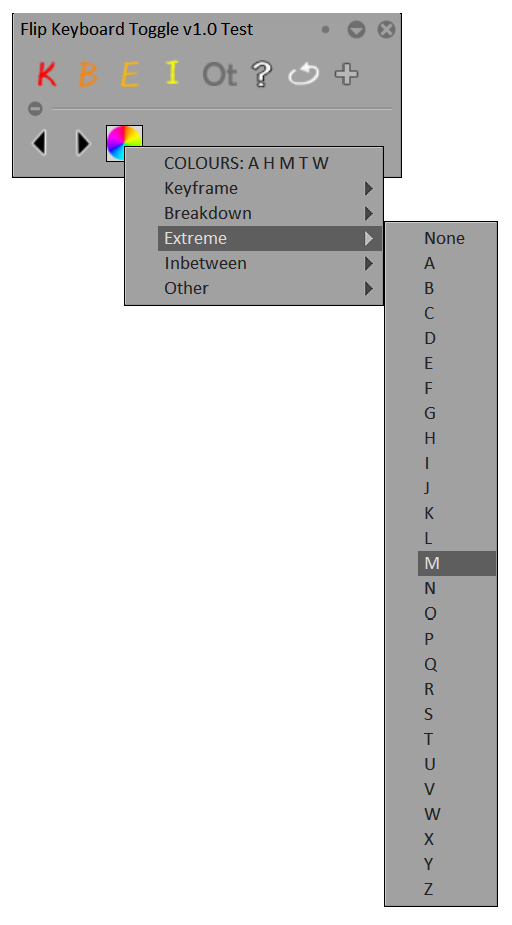

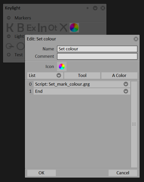

Regarding changing the colours of the marks, maybe you can add a button so one can do it from the panel and not having to go into the code.kelanhordos wrote: ↑30 Sep 2024, 23:21 If you are inclined, the code *I think* should be simple enough to add any number of flags/marks you want.
Code: Select all
// Set_mark_colour.grg
// Set colours for each type of mark
// Ask for type of mark
tv_listrequest "Keyframe|Breakdown|Extreme|Inbetween|Other"
PARSE RESULT number key_type
// Ask for the colour of the selected type of mark
tv_listrequest "None|A|B|C|D|E|F|G|H|I|J|K|L|M|N|O|P|Q|R|S|T|U|V|W|X|Y|Z"

// Display the colour scheme
tv_warn "Keyframe: " keyframe_mark_colour '\n' "Breakdown: " breakdown_mark_colour '\n' "Extreme: " extreme_mark_colour '\n' "Inbetween: " inbetween_mark_colour '\n' "Other: " other_mark_colour
Code: Select all
tv_ReadUserString "LukasSketchPanel" Keyframe
keyframe_mark_id = RESULT
tv_WriteUserString "LukasSketchPanel" "Color" keyframe_mark_id

I noticed something regarding the wrap option. It seems to only work when activated within a layer and not after the last frame of a layer.
In the timeline, if I place the player head/indicator after the last frame of the selected layer then I select 'wrap on', it won't actually wrap. It works again if I place the player head within the layer and then I select 'wrap on'.

That made me think and I came up with this button, where the action is as follow (still using the markers' code from Lucas Sketch Panel):
- breaks the instance using 'Set Keystroke' > Layer > Exposure > Break
- sets the colour variable of the mark to 0 (meaning transparent) using
Code: Select all
tv_WriteUserString "LukasSketchPanel" "Color" 0
- finally uses Lucas' script 'color_marker.grg' which would mark the new instance with the transparent colour

Regarding the wrap, I have it set to function that way, from the documentation
Adding another button would be pretty simple I think, but I can write something up when I have some time on how to do it so its clearer without having to decipher my code lol. Hopefully I can get that other button made soon as well.
And honestly, the doc is in part to help me remember, because I originally had it functioning the way you are asking for which is it would wrap no matter where you are. I don't remember exactly why I changed it. I've put a quick fix here in this version for that kind of functionality, it just comments out that part of the script and now on the forward/backward buttons it will wrap to the first/last frame when outside the layer. You will need to push forward/backward again after that to get to the next flagged frame, but I think this may have been part of the reason why I changed it as its a bit different compared to the function of the wrap when it's from inside the layer and I didn't figure out a better way yet.Wrap will only function WITHIN a layer's images, so if you use your mouse or another shortcut to go outside the current set of images(to an empty frame) and try and press F/G, wrap is automatically turned off and you will proceed frame by frame as normal. If you use the shift F/G key to get outside, then add a new image, Wrap will continue to stay ON.

I see. Well I guess maybe is best to stick to TVPaint's default behaviour. I only noticed it because I did a quick test of your panel on a very small timeline which is maybe less likely to be the case on actual projects.kelanhordos wrote: ↑09 Oct 2024, 13:38 Regarding the wrap, I have it set to function that way, from the documentation
Also, the change seems to break the previous change of going straight to the previous/next head of each marked instance you did to the "Flip Keyboard Toggle v1.0 for JR" version. Now it reverts back to to go to each marked frame. Eventually I'll have a look too on how we can have both: going from head to head and being able to wrap outside the layer, and I'll share my findings in case I do find anything.

I allowed myself to experiment with a "set the colour" button to work with your panel. It is more or less copied from your 'Check' menu
For some reason it only works with the keyframes and breakdowns for now. I wonder if I need to reset the config file. Anyway, in case you are interested, here is the script so far for a 'Set the colour' button (It is very much hot off the press), which in essence creates a new variable for the id of the colour selected for each type of marks:

// Sets the lists with submenus
colour_choice = 0
tv_listrequest "COLOURS: "keyframe_colour breakdown_colour extreme_colour inbetween_colour other_colour submenu("Keyframe") submenu("Breakdown") submenu("Extreme") submenu("Inbetween") submenu("Other")
PARSE RESULT colour_choice submenu
IF colour_choice == 0 || colour_choice == -1
EXIT
END
// Set Keyframe colour
IF colour_choice == 1 || colour_choice == 2 || colour_choice == 3 || colour_choice == 4 || colour_choice == 5 || colour_choice == 6 || colour_choice == 7 || colour_choice == 8 || colour_choice == 9 || colour_choice == 10 || colour_choice == 11 || colour_choice == 12 || colour_choice == 13 || colour_choice == 14 || colour_choice == 15 || colour_choice == 16 || colour_choice == 17 || colour_choice == 18 || colour_choice == 19 || colour_choice == 20 || colour_choice == 21 || colour_choice == 22 || colour_choice == 23 || colour_choice == 24 || colour_choice == 25 || colour_choice == 26 || colour_choice == 27
colour_choice = colour_choice - 1
key_type = Kflag
END
// Set Breakdown colour
IF colour_choice == 28 || colour_choice == 29 || colour_choice == 30 || colour_choice == 31 || colour_choice == 32 || colour_choice == 33 || colour_choice == 34 || colour_choice == 35 || colour_choice == 36 || colour_choice == 37 || colour_choice == 38 || colour_choice == 39 || colour_choice == 40 || colour_choice == 41 || colour_choice == 42 || colour_choice == 43 || colour_choice == 44 || colour_choice == 45 || colour_choice == 46 || colour_choice == 47 || colour_choice == 48 || colour_choice == 49 || colour_choice == 50 || colour_choice == 51 || colour_choice == 52 || colour_choice == 53 || colour_choice == 54
colour_choice = colour_choice - 28
key_type = BDflag
END
// Set Extreme colour
IF colour_choice == 55 || colour_choice == 56 || colour_choice == 57 || colour_choice == 58 || colour_choice == 59 || colour_choice == 60 || colour_choice == 61 || colour_choice == 62 || colour_choice == 63 || colour_choice == 64 || colour_choice == 65 || colour_choice == 66 || colour_choice == 67 || colour_choice == 68 || colour_choice == 69 || colour_choice == 70 || colour_choice == 71 || colour_choice == 72 || colour_choice == 73 || colour_choice == 74 || colour_choice == 75 || colour_choice == 76 || colour_choice == 77 || colour_choice == 78 || colour_choice == 79 || colour_choice == 80 || colour_choice == 81
colour_choice = colour_choice - 55
key_type = EXflag
END
// Set Inbetween colour
IF colour_choice == 82 || colour_choice == 83 || colour_choice == 84 || colour_choice == 85 || colour_choice == 86 || colour_choice == 87 || colour_choice == 88 || colour_choice == 89 || colour_choice == 90 || colour_choice == 91 || colour_choice == 92 || colour_choice == 93 || colour_choice == 94 || colour_choice == 95 || colour_choice == 96 || colour_choice == 97 || colour_choice == 98 || colour_choice == 99 || colour_choice == 100 || colour_choice == 101 || colour_choice == 102 || colour_choice == 103 || colour_choice == 104 || colour_choice == 105 || colour_choice == 106 || colour_choice == 107 || colour_choice == 108
colour_choice = colour_choice - 82
key_type = IBflag
END
// Set Other colour
IF colour_choice == 109 || colour_choice == 110 || colour_choice == 111 || colour_choice == 112 || colour_choice == 113 || colour_choice == 114 || colour_choice == 115 || colour_choice == 116 || colour_choice == 117 || colour_choice == 118 || colour_choice == 119 || colour_choice == 120 || colour_choice == 121 || colour_choice == 122 || colour_choice == 123 || colour_choice == 124 || colour_choice == 125 || colour_choice == 126 || colour_choice == 127 || colour_choice == 128 || colour_choice == 129 || colour_choice == 130 || colour_choice == 131 || colour_choice == 132 || colour_choice == 133 || colour_choice == 134 || colour_choice == 135
colour_choice = colour_choice - 109
key_type = OTflag
END

Hi Jeremy, that looks great and is pretty much what I am doing to update it as well. Sorry, I realize I adjusted the wrong file when I fixed the wrap issue, so I will not hastily upload another version especially since you have made modifications.
But, to fix the wrap this is the change to the wrap code around line 56/57 to this code in FlipkeyboardBackward and Forward respectively. It's just turning off what was there and jumping to the last/frame instead when wrap is ON.
for backward
and forward
And just fyi the code that made it skip the instances and only go to the heads is the bold part here, added to each mark check (i cant make it bold in code format) Since there is already a check at the beginning of the loop with tv_exposure to find out when it is "out of bounds" of the layer for the wrap code, this is an easy way to add it.
for backward
Code: Select all
IF wrapflag == 0 //If wrapping if off, will move to prev exposure
tv_exposureprev
ELSE
//tv_writeuserstring [kcustom] wflag 0 //If wrapping is ON, will turn it off, and proceed with rest of script
//wrapflag = 0
//tv_exposureprev
tv_layerimage LAST
END
Code: Select all
tv_exposurenext
ELSE
//wrapflag = 0
//tv_exposurenext
tv_layerimage FIRST
END

Thanks. I'm just not sure how manageable it is in the long run to have so many variables, but I guess it still better than having to go back and forth between what it is essentially two same codes.kelanhordos wrote: ↑13 Nov 2024, 15:58 That is a great idea to make changes to the code easier with the variables, nice job.
Anyway here is my version of your panel:
It has the changes you made for me which made it go from marked heads to marked heads and it has the 'Other' flag.
Sharing the panel, I though I'll have a go at trying to translate it in French, stuff that can be translated anyway.
I'm using it in TVPaint 11.7.3 but it seems to be working in TVPaint 12.
Here are the George scripts used in the panel:
I ended up transferring the embedded scripts into separate script files and used the #INCLUDE instruction; I found it easier to update the panel this way, and I'm less likely to lose portions of code if the panel didn't save properly for whatever reasons. And it is more practical when sharing the panel I think.
The pictograms for the icons are from the Webdings and Wingdings fonts and the colour wheel is from Wikipedia, https://commons.wikimedia.org/wiki/File ... _wheel.png

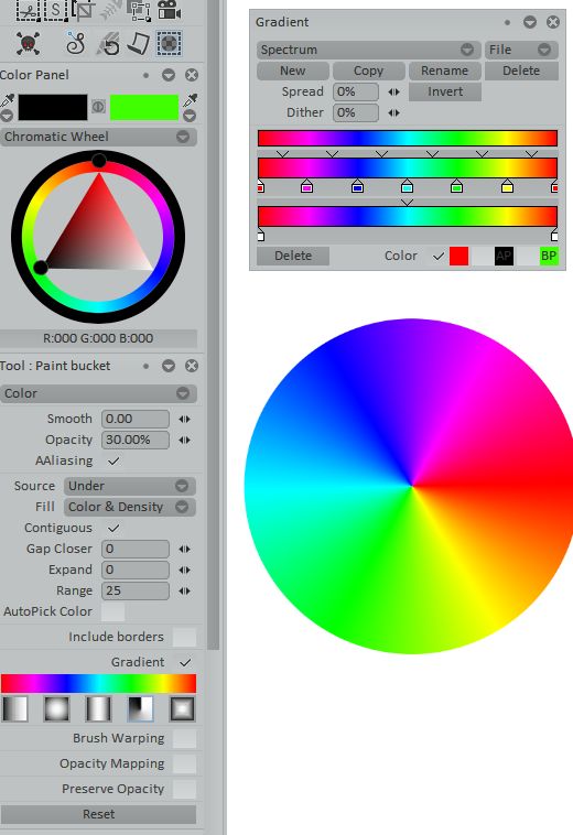

- Posts: 4517
Re: Custom Panels for flipping between Keys, Breakdowns, Inbetweens etc.
btw... a colorwheel is very easy to create in TVPaint using the preset "spectrum" gradient
in a filled circle with a "Radial Gradient"
