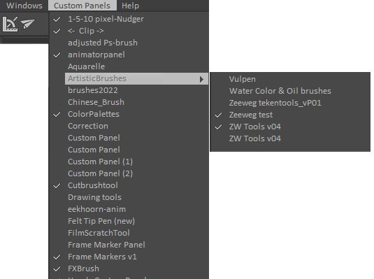

i have quite a large collection of custompanels.
it would be nice if we could organize them by having folders so i can group them in categories.
Much like the "windows" pull down looks now.

Hey, I just stumbled upon a bit of a workaround to this by accident and I haven't found it anywhere else on the forum.
If you rename your custom panel to whatever category you would like, for example in your screenshot "ArtisticBrushes" add a "/" after so it looks like "ArtisticBrushes/PanelNameHere" (without quotes) and it will add exactly what you have in your screenshot(which I'm assuming was a mock up, if this was already known then please ignore!). You can even add another SUB menu by adding another /, like ArtisticBrushes/MyPanels/PanelNameHere.
I'm not sure of any downsides/bugs from doing this yet, but aside from having to rename your panels if you want to export them without really long names it seems to work.

Wow!!!
That is crazy!
Assuming this functionality was there all along ...i consider it an "ok-done" from Hervé from his grave.
How i miss the guy.
Thank you for stumbling on and sharing it!
That is crazy!
How i miss the guy.
