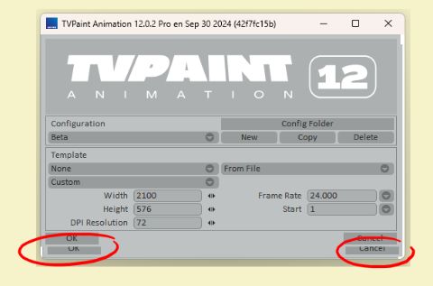

Re: TVPaint Animation 12.0.2 is available!
the start-up panel has this glitch (again? i remember seeing this some builds before)
this glitch appears when i drag the opening panel from the primery monitor over to my cintiq

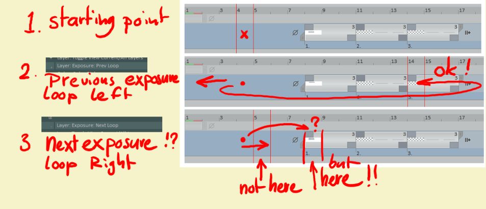

Posts: 4494
something i noticed.
a function i use daily... the Layer: Exposure: Next/Prev Loop
i assign them to "<" and ">" keys
1) i'd request this to be a default, it makes you navigate heads only
(btw.... shouldn't the name be: next/prev head or instance?)
anyway this is a vmore convenient way of skipping through an animation then using the arrow keys who only advance 1 frame at a time
2) i noticed a glitch
in which, when you are on a layer outside of the range this function does no longer jump to the next instance/exposure or head but instead advances just one frame...
if you go the other way it does work... making this behaviour a bit funky
long story short.
could you fix this function so it would always jump to the head and not only if you are on an image?
in the below example ... if i want to go the the first exposure i have to first click "<" (left) to go to the most right exposure
and then click ">" (right) to go to the first, the most left, image of the layer.
it is a bit messy

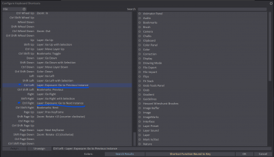

Peter Wassink wrote: 09 Oct 2024, 11:43 something i noticed.
You can use the shortcuts for next/prev instance which are CTRL + left/right arrows
Peter Wassink wrote: 09 Oct 2024, 11:43 2) i noticed a glitch
long story short.
it is a bit messy
I can't reproduce your issue. I mapped the shortcuts as youyrself and I don't have this "glitch".
As I told you above, you should maybe reset your configuration.

the issue with
Layer: Exposure: Go to Next/prev instance (using CTRL-arrow keys... good enough as a default btw!)
is not resolved by resetting, maybe you misunderstood the issue?
with both settings when you are either in front or behind the layer you only go one frame at a click... in single frame steps towards the layer.
to me that is not logic.
When on the layer you jump from head to head.
And i expect, when you are off the layer, to the left or to the right , to directly jump to the first instance (coming from the left side) or the last instance (coming from the right side)
"Go to next instance" should..... ehm :mrgreen: ... Go to next instance, and not just next frame.
