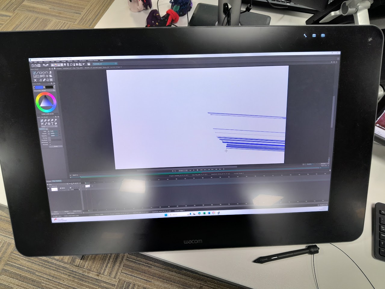

've got a tricky one here that I am hoping that you can help with.
This image shows what is happening.
I work in a University and I support Tv paint. I was unaware that this machine had been updated to Windows 11 by our IT department and this seems to be what has caused this issue.
I have ruled out it being an issue with the tablet itself by updating the driver and testing it out in Photoshop and Toon Boom which both work fine.
Can anyone help me with where to look next?
Many thanks!
Pete.

Re: Issue on TVpaint 11 on Windows 11 with Wacom Cintiq
i believe this issue was solved,
in this thread:
https://forum.tvpaint.com/viewtopic.php ... 88#p136788
Posts: 1143
Yes exactly, thank you Peter.
Also, a fix for this issue was introduced in the newly released v11.7.5, similar to the one implemented in v12 earlier.
Post by petefelstead »
That's fantastic and really helpful, issue sorted, thanks!
