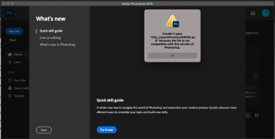

Thank you for the help, I was looking for this answer too. The problem I'm having is that the .PSD files that were exported from "Clip: Layers Structure" are incompatible with my version of Photoshop (2025). I get the error "Couldn’t open “Clip_LayersStructure00000.psd” because the file is not compatible with this version of Photoshop."
Any thoughts to why this is happening? Thank you so much
