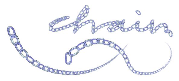

you could also consider to create a 2frame animbrush with chain shackles, set angle to direction and draw the curved lines of the chains, the brush will place the shackles on the lines.
...oops
i just realized chainlinkfence means something else. i thought you ment a chain link.

- chain.jpg (19.74 KiB) Viewed 11982 times
