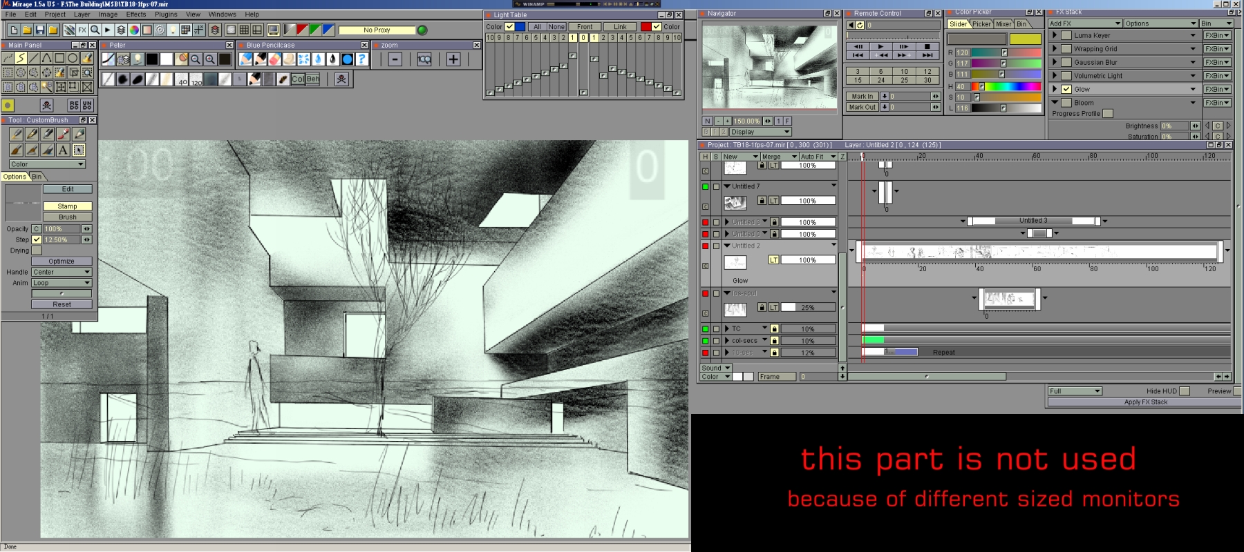

i have worked with two different sized monitors with TVP for quite a while.
And although it is sometimes awkward to move the pointer between them ( it often gets 'stuck' at the gap) it does work.
you have to make sure the 'main' window is NOT maximized then you can stretch it across any monitor configuration you like
an old screenshot from an uneven monitor config, the black part is the Gap

sadwinkingemoticon wrote:... You can't "stretch" any program across two monitors that are different resolutions, only when they're run at the same resolution. At least that's been my experience.
what CG/driver do you run, Sad ?
I personnally can run tvpa across 2 monitors with different sizes AND different resolutions without any problem .
(NVidia 7600GT, Desktop extended to the 2nd monitor checked ON in the windows display properties)
of course, as mentioned by Tantalus, when tvpa window is extended beyond one of the screen areas
(black area on the pict.), you can't reach this area, more exactly, the cursor (or panel in there) disappeared
outside the monitor displays, in "Hiddenland".
