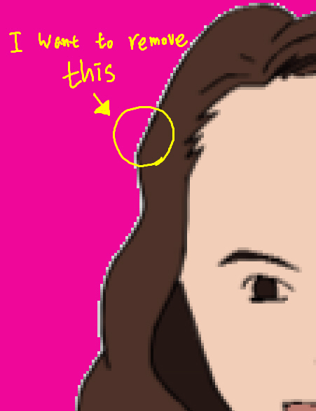

Greetings, everybody.
I have a question.
I used Luma Keyer to remove white color.
Please refer to the following picture.-the original image and the image used luma keyer
But, It is not what I wanted. The border is not clear and messy.
I know the Power Retouche Pro plugin for photoshop. This plugin can remove anti-alias.
I'd like the clear border. Because I work many images, I want to remove white color(anti-alias) at a time.
Please tell me, How to simply remove...

Scan Cleaner remove other colors. I only want to remove white color (anti-alias)

Hi~ ZigOtto
I understand you, as I have used a photoshop
TVPaint is a good program to create a 2D animation.
But, It's a pity there are no drawing function of correction like Adobe Flash.
My drawing line is zigzag. I want for line compensation function.
So I am using a Demo Verson Software(not Flash) , This software is a good for drawing and painting in 2D cell animation. (like Animo)
But It can't export due to demo verson. I capture a most big screen using caputer utility.
Alpha isn't in captured image. So I want to remove a white color (anti-alias next to border line)

Thank you...a detailed explanation.
But Idon't what I wanted. I'm so sorry.
I paint in demo software. Because The software can paint too easily.
for example,
* Automatic Color Trace
* Paint overflow Detection and close fill function - This function is in TVPaint. but this is much better than the TVPaint.
* Paint with light table color function - like auto pick color of the TVPaint
and so on...
so I take advantage of this software.
anyway, Thank you again for your interest in me.
