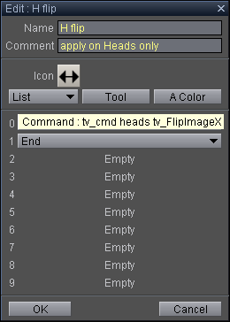

Re: Flip a sequence horizontal, is that possible
well, to answer to Tommie first question, I think the easiest way
to Horizontal-flip a selection of frames without breaking the Instance's exposures
actually is to make yourself a Hflip custom button with this single command :
Code: Select all
tv_cmd heads tv_FlipImageX
see attached pict.
8)
but I agree this can be add to the future requests list :
- make the Horiz./Vert./Both Axis Image Flip commands repecting the Instances
(working on Heads only).
malcooning

ZigOtto wrote:well, to answer to Tommie first question, I think the easiest way
Code: Select all
see attached pict.
8)
cool. I wasn't aware the 'heads' is usable in all those forms.
