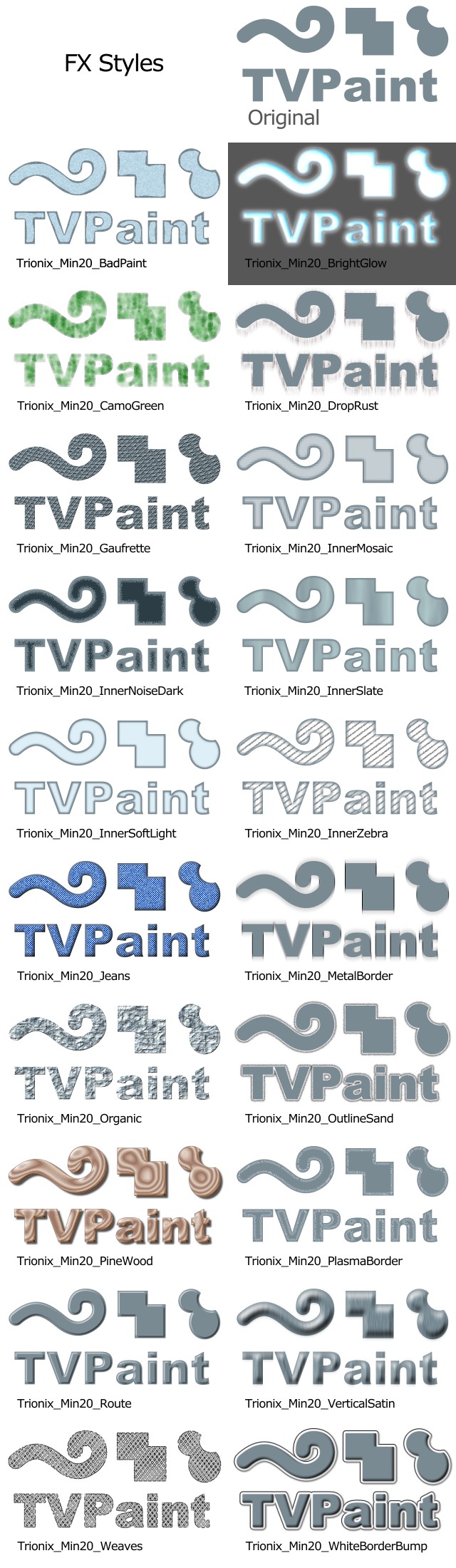

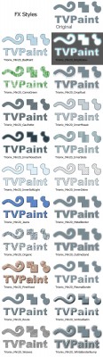

Here is a zip file containing 20 bin files for the FX Stack.
These effects apply fantasy style to shapes or texts, minimum details should be 20 pixels wide.
For TVPaint Animation Pro only.
TVPAPro : 20 styles
TVPAPro : 20 styles
