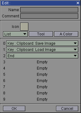

hmmm, this requires a little script imo,
meanwhile, to merge (flatten) a multi-layered frame in one new image-layer, you can use this :
yeah... but the clipboard never heard of no alpha...
