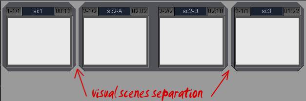

Re: Clips vs Scenes
As you can see :
I'ts a little like in animation with instance / exposures.
If you add a scene : you will create a new scene with 1 clip
If you add a clip : you will add a clip into a scene. It means there will a new image into your scene.

Clip and Scene difference ? Scene is the upper level in the project structure hierarchy, (Project/Scenes/Clips/frames)
suppose you just created a new project, you got a single Scene/Clip project, with one frame,
if you [Add Clip], you will add a new Clip to the already existing Scene, so you will get a single Scene containing 2 Clips,
if, instead of adding a Clip, you [Add Scene], you will add a new Scene to the first Scene, so you will get 2 Scenes,
each one containing 1 Clip
so I'm considering Scene tools as features to work on group of Clips,
(f.i. deleting a Scene will delete all Clips belonging to this Scene, that's all.
in the project tab (thumbnails view), the representation of scenes is the bounbing strip (beveled corners)
surrounding clips belonging to a same scene,
and the discontiniuty of this strip (vetical empty space) means passing from one scene to the next.
