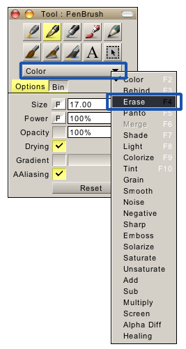

Any drawing tool can be set to erase. Look at the little window below the Tool: panel where it probably says color right now. Change that to erase. Ask away because there's more you'll like, such as the ease with which you can create your own pencils, erasers with your own icons in something called the Custom Panel.
Re: TVP help for demo users!
And the Erase is in fact a mode for you brush, like Color, behind, tint, multiply etc...
It means any brush can be what you want. :D
