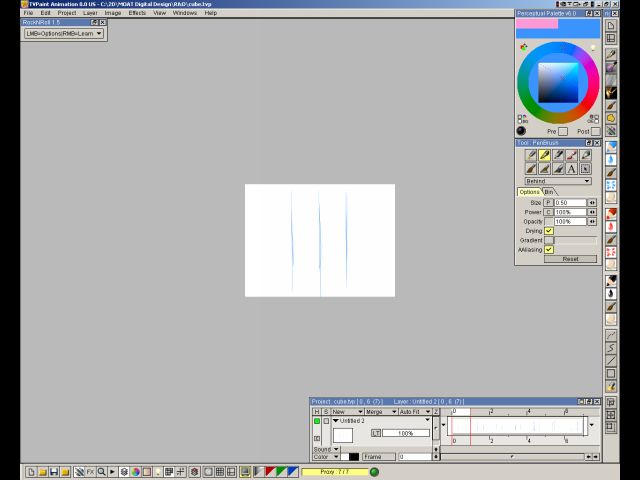

Ha ha ha because it's just ONE command -- I'd wind up having to make a custom panel for just one button -- when we already have a perfectly usable Animator Panel that we can add to -- As much as I love CP buttons, I don't like making too many of them because it starts to get rather cluttered...
Marco wrote:And I've been making a little bit of publicity for the software at my friends last time. The panel could be usefull to convince them. And do the scripts also work on a Mac?
Marco
I believe that GRG scripts (which don't require any compiling) should work just fine, cross-platform...
good bye clutter!
good bye clutter!
