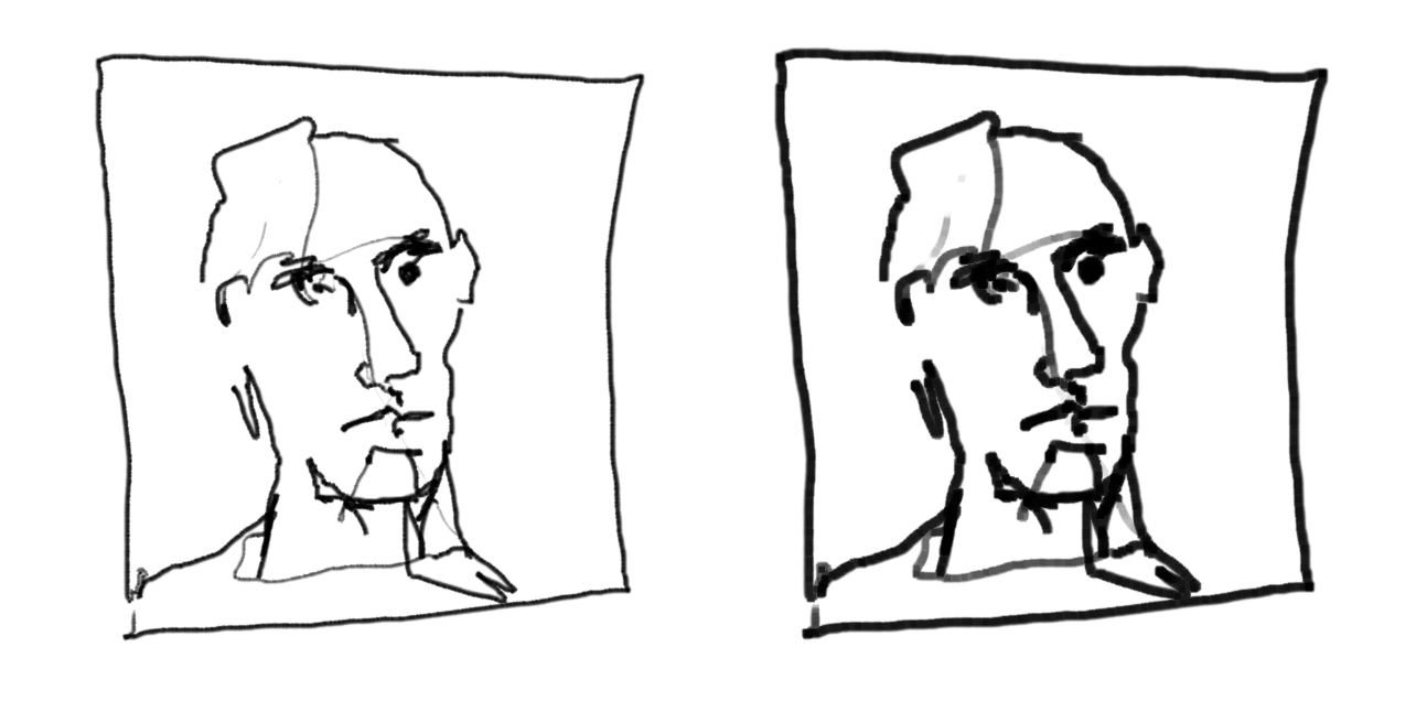

because I am changing the size of different drawn elements within a frame, I am trying to apply some overall consistency of line width.
I might for example take some element of a previous shot and paste it in and reduce its size by 80%. I am trying to find a way to fix up the subsequent reduction in line width...does that make sense?
below is a drawing to which I have applied the "minimize" filter in photoshop, which spreads the pixels by a given amount..
thanks again (from the hemisphere where it is winter)

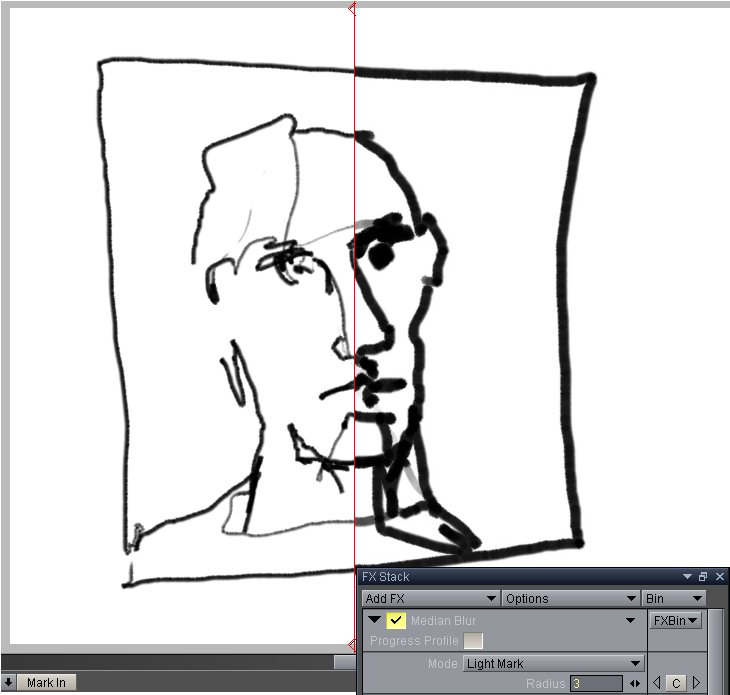

well, I'm not a PS user, but looking at your image sample, it looks like the TVPA "spread/choke" equivalent filter
is Blur/Median Blur/ LightMark/DarkMark filter.
if your line-drawing is on a transparency layer, applying the LightMark filter will make the lines thicker,
and in the opposite side, the DarkMark filter will "eat" the lines, making them thinner.
(if the lines are drawn on a white BG, you will have to process a "flat" ScanCleaner_fx first).
apart that, the Stylise/ Add Border_fx works pretty well too, specially since the decimals are available in the value setting ... 8)
