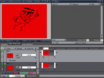

では、たぶんこれもバグだと思います。
グレースケールの.psd ファイルを読み込むと赤と黒からなる画像になってしまいます。
変換時のバグかと思われます。

では、たぶんこれもバグだと思います。
変換時のバグかと思われます。

Re: バグ報告
(sorry, but in english only)
and to recover the layers's transparency, you just have to stack a B&W converter_FX + a ScanCleaner_FX,
and to Apply the FXstack on each layer.
(to see the "before/after" animated gif example, click on it).
possibly a PSD bug, meanwhile, it's not a big deal with tvpaint to get rib of the red backgroundten_zero wrote:(taku's question translation)
"I have problem when I import a 256 gray scale PSD docment on TVPaint project, the docment color converted to Red and Black.
Is that a bug ? "

Re: バグ報告
Hello
Fabrice san
I made .psd files and Up load to here .
http://www.lovelips.net/tvp/gray_psd.zip" onclick="window.open(this.href);return false;
The transparency area of the layer makes trouble.
Only the layer in the right under reddens.
Fabrice san
Re: バグ報告
OK, the bug should be fixed in the next update.taku wrote:Hello
Fabrice san
Hervé ADAM, TVPaint Team
