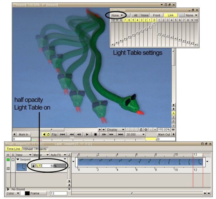

The other thing to consider is to do what many professional Stop-Motion animators do and use a DSL to capture , but mount a tiny webcam parallel to the DSL camera . This would allow you to use a DSL with your Macbook for stop motion capture. The webcam provides the live-video feed to TVP on the Macbook so you can use the "Mix" (onion-skinning) and Light Table controls to see your previous frames compared to the current live frame , as an aid to calculating your spacing when moving the puppet (as shown below) , but the actual high-resolution images are captured to the digital camera's memory card. Then you transfer the high-res. images to your computer and open them in TVP for adjusting the final timing or to use the digital paint tools in TVP to remove wires or other visible rigging from the the captured frames . This is one of my favorite features of TVP for stop-motion work. It's so easy to use a clean plate of the empty set on one layer underneath the animation layer , then simply erase out any visible rigging on the animation and the erased areas show the clean plate on the layer beneath , so it's seamless. (this only works for locked-down shots , no camera movement) But even with a moving camera shot you can use the digital paint tools in TVP to paint-out rigging .
