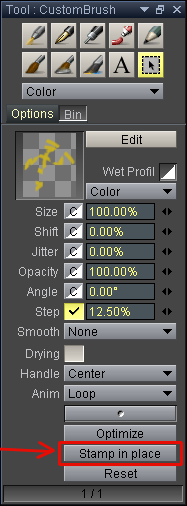

also, (haha) i can't seem to find the paste in place option for tv paint. Any clues?

now I just need to find the paste in place function haha. Anyone have any idea where this function is i've looked all over

madteo wrote: now I just need to find the paste in place function
once a custombrush copied (or cut),
you should find the command at the bottom of the Tool panel, just above the last [Reset] button .
