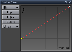

yeap, the trick is to have your Drawing/Erasing tools at different size, (we usually have our eraser bigger than our pen, that's from our old "natural media" habits).
Paul Fierlinger wrote:... the Erase size has to be set to "none" which shows up as the letter "C" (go figure).
not necessary, you can keep the eraser's size connection to "Pressure", but set the enter point (down-left corner) of the Size Profile over than 0, (say, at 1/4 of the max size).

Zig, where do you find these things out -- I've been around these forums for 12 or 15 years and this is the first time I've heard of this profile shape to preserve the circle around the cursor's point!

ZigOtto wrote:you can keep the eraser's size connection to "Pressure", but set the enter point (down-left corner) of the Size Profile over than 0, (say, at 1/4 of the max size).
Brilliant! That is completely logical... which is probably why I hadn't thought to do it! Thanks for the tip - I like to have my eraser set to pressure, so this is a great help. :D :D :D
