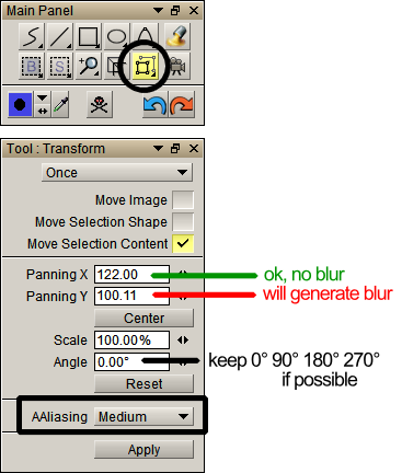

If you are copying/pasting with a custombrush, you should be able to change the Smooth option (none, medium and best), as shown below :
If you are using the transform tool, there is the AAliasing option to change in the same way.
Also, please try to use integer values (nothing after the coma), as shown below.

Fabrice wrote: If you are using the transform tool, there is the AAliasing option to change in the same way.
I have learned something new: all this time I did not understand this . (i.e. "use integer values (nothing after the coma)") Did I miss that in the User Manual or does it need to be added to the User Manual ?
However, most times when using Transform or Warp it is impossible to make the X or Y positioning precisely an integer value with nothing after the comma. Also when using Transform it is often not practical to keep Angle set precisely to 0∘, 90∘ , 180∘, or 270∘.
But I should say that I don't usually notice any blurring until I have transformed something several times . Just transforming once or twice to adjust size or angle on a drawing doesn't seem to have noticeable blurring.
