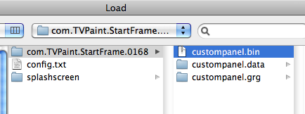

Hi Eric,
Thanks for your reply.
I will try to show what is happening:
[attachment=2]1_new-toolbar.png[/attachment]
I do get the custom toolbar, but without any functionality. And I do not see how to get it in there.
Any suggestions?
Thanks.
Any suggestions?
Thanks.
- 3_the-toolbar-after-loading.png (5.11 KiB) Viewed 24518 times
- 2_load-bin.png (24.15 KiB) Viewed 24518 times
- I open a new toolbar as shown
- 1_new-toolbar.png (9.73 KiB) Viewed 24518 times
Re: Change project start frame
Hi keepshooting,
Were do you get these .bin and .data files from ?
In the posted zip file, there in a single .tvpx file.
You drop that .tvpx file onto a running TVPaint and it will be installed.
Maybe the app you used to decompress the zip does crazy ?
A+
A+
"Were do you get these .bin and .data files from ?"
Wel I downloaded the link given earlier in this thread (on an iMac OS X 5.8 ) so it could be the OSses unzipper then.
Downloaded the file onto the MacPro (OS X 6.8 ) There it showed the .tvpx file. Still it would not install properly: it did not show the extension in the second "loading extension" window - the window was empty.
Then I tried downloading the last update of TVP (was working on 9.5 ), cleaned the preference-folder of all old folders and now it works fine!
Thanks, Conny
