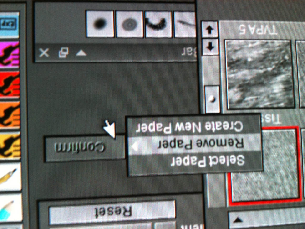

I am having trouble deselcting a paper choice - has anyone else encountered this?
I rt clicked the paper I wanted to delselect and the comfirm button appears to be greyed out ( see photo)
so I am unable to delselect the paper that is highlighted in red- this has happened to me several times.
djsolomon
ps sorry the photo is appearing upside down!
its rt side up on my end...

The papers that come by default cannot be removed this way. This Remove button is only for paper you have created yourself. If all you want to do is disable the paper from your pen, just toggle off the paper button.

It's a preset paper I cant get rid of..
where does one "toggel off " the paper?
( I dont see a button to do that in the paper panel)
thanks so much
djsolomon
Re: Paper panel problem....
to toggle on/off the paper, it's the Paper button from the main bar (it's not inside the paper panel),
(the button is located at the 5th position from the end, between the Stencil button and the Grid button),
you have to open and go to the paper panel only when you need to select/change of paper,
and to tweak the different paper's settings (hardness, invert, flip, ...etc).
Posts: 2982
The papers are accessible via the finder (Mac): TVP -> LMB, "show contents", contents -> resources -> papers. I've deleted all I didn't need. (They'll come back with the next install, so I have to repeat this step with each upgrade.)
