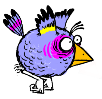

Let's say I want to select a specific color and erase it. Or, select it and paint over the selection. For example - see the image I attached - I want to select all the light-blue color and paint inside the selection. The only way I could do that is use the Magic Wand, but see how many other colors are painted over the blue color, so I cannot select it in one click, I will need to go patch by patch, and it's really not efficient...
In Photoshop there is a simple function "Select Color". In TVP there is no way to do that... (I know TVP is not Photoshop, but IMO this function is necessary for easier painting process)
Or am I missing something?

Soom wrote: In Photoshop there is a simple function "Select Color". In TVP there is no way to do that... (I know TVP is not Photoshop, but IMO this function is necessary for easier painting process)
Thank you for the explanation, I understand better now. Yes, You're right, such a selection could be interesting. =)
At the moment, I advise you to use the FX "color > color replacer" to proceed with such a change.
