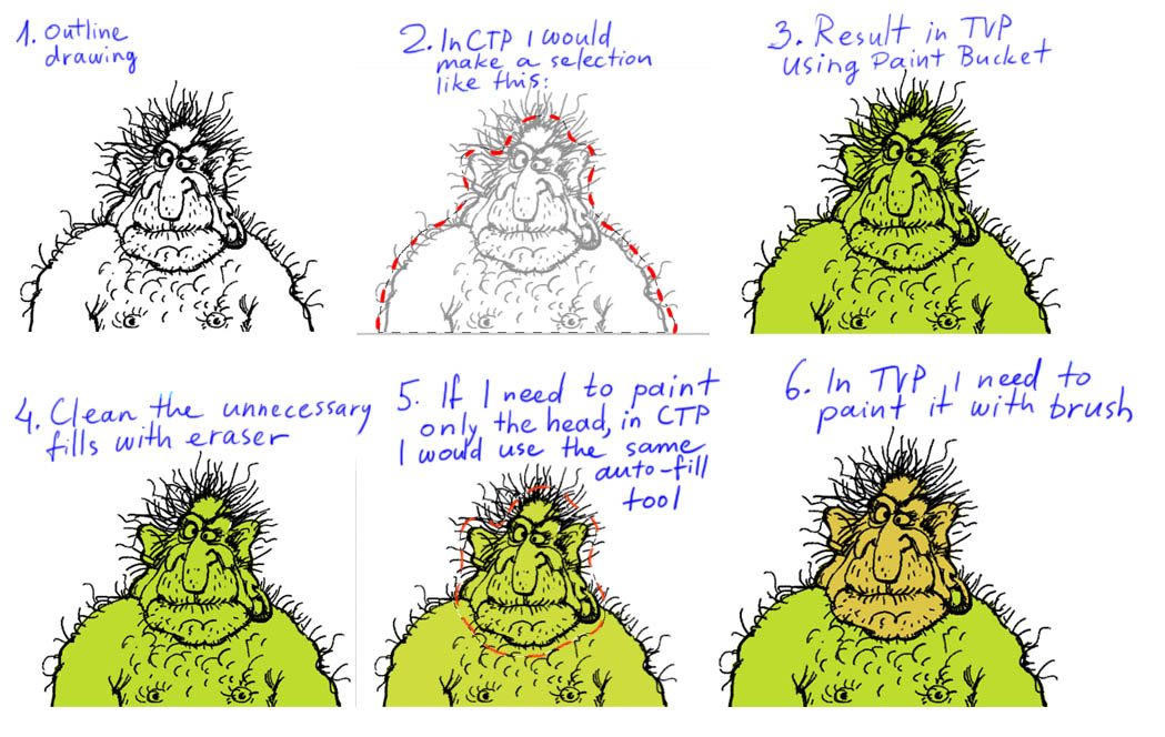

This method is the closest to what I need, yet I think there is a very slight advantage of what I propose, in terms of amount of clicking around:
Here is a very quick example of what I mean (see picture) - maybe not the best one - I just did it for demonstration, as I didn't have my project in question under my hand:
1. Let's say I have an outline like that -a bit fluffy and several closed areas to be filled.
2. If I need to paint everything, In TVP I would use your method = 2 clicks for selecting tools + more clicks for changing prefs in the floodfill tool settings. in CTP I would use the auto-fill tool to draw an approximate selection around all the closed regions = 1 click.
3. This is a result in TVP - as you see, anyway lot's of areas in the hair are filled, so need cleaning. Although cleaning would be needed anyway in CTP too, but much less.
4. The clean result
5. But then what If I want to fill only the head? In TVP I need to either draw a separation line on the color layer, either just paint everything with a brush. In CTP I would use the same auto-fill tool with similar results.
6. The result.
Well, I think basically when you need to paint loads of images, hands get used to paint very fast in TVP too, but I still think this kind of tool would be just a good addition to filling functionality of TVP - it's just more simple in it's idea...
You can use the stencil to keep the outline (since that doesn't change) so you only have to pay attention for the line between head and body.
For instance use the freehandfill tool draw a fast wide circle around the head and only go slow and precise for the part where head and body meet.
because the stencil only allows the new color on pixels already there, there is no risk of going outside of the outlines. this would work pretty fast

Have no idea how this works in other software - in CTP there is no vector object as far as I understand - I think there is just a script, that recognizes all the closed areas on the outline layer...Fabrice wrote:I might be wrong, but a such tool would need an object (=> vectorisation of the drawing) to paint inside. (because without object, it's not possible to recognize the inside and the outside of a drawing)
I will ask to the dev team if something can be done anyway.
Peter Wassink wrote:not everything....
I'm using the "preserve transparency" to use only the present pixels - forgot to mention.
I didn't think about the freehand fill tool - thanks – will try that and see what's faster, but still - need precision in those connection areas, which take more time...

From your sample image I can't believe that any software would be able to automatically decide which of the black lines was hair and which was the body outline. (I've used Toonz and Animo myself.) Unless you carefully follow that body outline with your selection tool, any software would give the result as in Nr 3.
