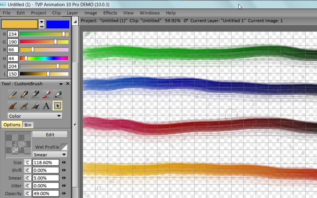

It mixes the colors well enough but if you pick green for example on an empty canvas and keep drawing
without lifting the pen, you can see the color fade from green (or any other color) to black.
The second image shows the large paintbrush with a smear value ranging from 0 (top) to 2 (bottom stroke)
every time using the same yellow. Is this how it should behave? Feels awkward to me at least.

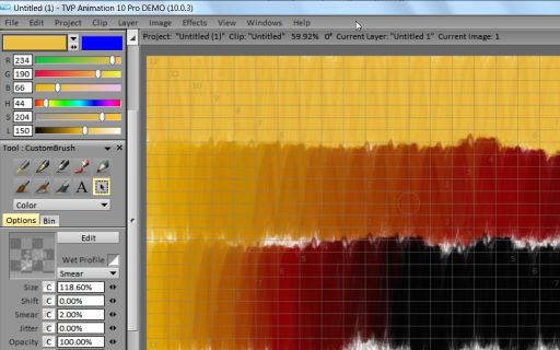

Hi,
I played around a little more with this and I have noticed a couple things :
If I fll the layer with a base color, uncheck the paper setting and keep the opacity at 100,
the smear functionality is pretty reliable. However if I change the above settings the
brush very quickly fades from my selected color to black.
I think the underlying problem is how the smear works with opacity. I am not a technical
person but I get the impression that whenever the smear brush finds or works with opacity
it starts blending black into the smear.

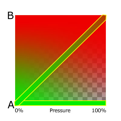

We have colour A (on the brush), colour B (on the canvas), alpha (on the canvas), and pressure (on the pen). These 4 variables have to go into 1 algorithm. Colour b is constantly changing during painting. The pseudocode would do something like that:
Pick B, pick pressure (between 0 and 1), calculate the pressure weighted median between A and B, apply the result and make it the new B.
To include transparency, it need to do something like this:
Pick B, pick transparency (between 0 and 1), pick pressure (between 0 and 1), calculate the transparency weighted median between A and B (=C), calculate the pressure weighted median between C and B, apply the result and make it the new B.
I'm not even sure how to say this in english, but I am sure that there's more stuff needed to avoid values outside RGB range, or totally silly values with no visible result. Maybe this graph adds logic:
The colour inside the yellow border shows the result.

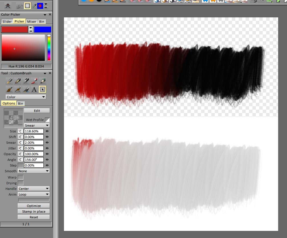

I was testing this the other day and I wasn't seeing the smear brush fade to black in the absence of other colors to smear into. The brush stayed the same color on an empty frame. I can test again tonight and post the results, but the smear only changed color if there was another color to blend with. I am using TVP 10.
Re: smear brush
I don't get it either; it works as expected but I don't work with colors all that much. Is this what you want to happen?
SMEAR TEST.jpg (32.62 KiB) Viewed 28998 times

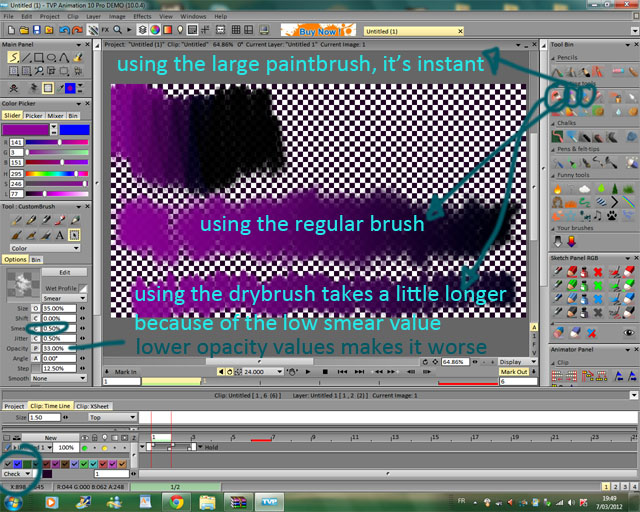

I follow this thread since it started to get a deeper understanding of what the smearbrush exactly does.
I tested a little bit (TVP Pro 10.0.4) and can absolutely confirm the behavior described by e1two.
- When painting on transparent areas the color fades to black. The higher the smear-value - the faster it fades. This don't makes much sense for me.
- When painting on a color (white in my example) the A color fades to the existing color. I think, the smear function is made for this behavior.
Here is a picture showing the different fadings. I used the "Large Paint Brush" from the Tool Bin without any modifications.

Re: smear brush
OK, I see what's going on; you are using those preset custom brushes someone like my wife, Sandra, a high-end background painter, never even touches. She either makes her own or uses those that other painter people around here have uploaded to share with all of us. A guy named Asaf makes especially spectacular water color brushes.
What you are using are brushes that are made with two colors. If you don't want to have two colors (which you obviously don't) just change the second color to the same color as the first (says Sandra) but If you don't want to fuss with that than it's easier to just use the smear brush in the tool panel -- which is what I did with my little smear job. If this is the only issue that's holding you back, just take the leap of faith, because TVP is clearly the one software does it all software -- though there are people here who specialize in taking the strange pleasure of switching between three or four different applications within two minutes of work.
