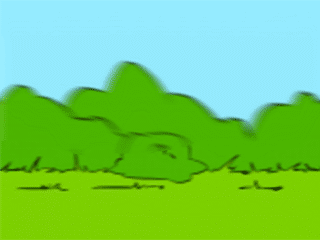

I try to do with a few layers and FX KeyFrame, but it is also difficult.
and GIF

Starkov wrote: I try to do with a few layers and FX KeyFrame, but it is also difficult.
and GIF
There is no reason for chopping up the BG on these extra layers as you have shown in your screen capture above. You are making it too difficult on yourself .
Just as in traditional animation if you had a long panning BG on a peg bar you would create an extra wide piece of physical artwork . In TVPaint it is as I showed you above : make the BG a separate project , 4 times wider than your regular project size .
The start field of the of the BG and the end field of the BG are exact duplicates , therefore allowing you to move the BG using the KeyFramer tool and because the end field is exactly the same as the start field you can create a seamless repeat cycle for the BG (or if you don't want the panning BG to repeat then you'll have to make an even wider BG project size , maybe 5 , 6 , 8 times wider than the normal project so there is a long pan , but with no repeat) .
