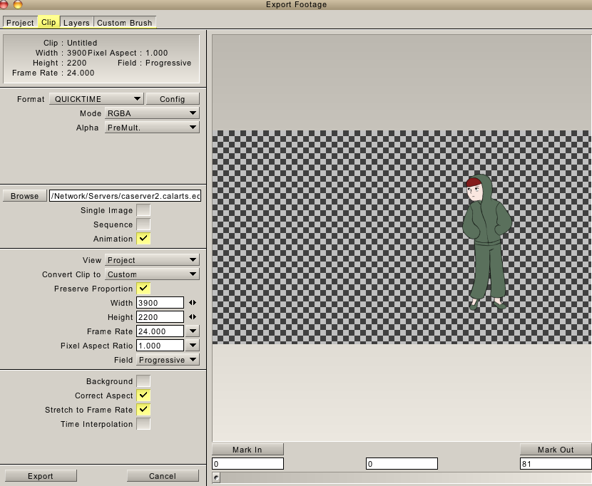

Re: Exporting sequence with alpha channels
Here's my export settings.
still no alpha channel.
- Screen shot 2012-04-14 at 1.47.04 PM.png (66.15 KiB) Viewed 37419 times
I tested your settings and they work. I didn't test in AE, but in NLE Vegas. I had to set the Vegas propertied to alpha and that was it. Which version of TVP do you have?
hmmm
strange
i have TVP 9 Pro
I exported as an mov and a sequence as a psd.
it's not working.
ugh, this is slowly stressing me out.
strange
i have TVP 9 Pro
it's not working.

try exporting your sequence in PNG32, it's my favorite format when it goes to export in 32bit.KathrynWilkins wrote: ... ugh, this is slowly stressing me out.
Kathryn, can you use another format besides QT? PNG should work everywhere.
Are you sure after effects interpret the alpha channel correct? In afx project window you can right click the footage and set the alpha to multiply.
Ah, ok so i exported a sequence as a png and THAT reserves the alpha channel.
IS there a way to export a video file with alpha channels and overlay it in aftereffects over a background?
Yes… the exact same way
(in Ae, just put the folder that contains your png's in the "project part" and add it to your comp… you'll get a new overlaying layer)
One remark though :
The deal with quicktime is inside the codec settings.
Quicktime can not manage the alpha chanel if you compress in some specific formats (like mp4, etc ...)
So if you want to keep the alpha chanel with Quicktime, you have to save uncompressed sequences.
so Kathryn, maybe by using the "config" button and enter in of the quicktime codec config, you might solve the problem.
On AE and QT alpha: exchanging animationfiles with an other company, I used tiff sequences with alpha instead. They told me the AE-version before the latest one has a 'known bug': QT alpha is not recognised.
On QT alpha in TVPAP 10: I would like to import movies with alpha (camera views of a layerd backgrounds that still need further editing) back into another TVPAP project. So I just made some tests with the QT alpha, uncompressed 10 bit 4:2:2 as wel as uncompressed 8 bit 4:2:2 and it is not working. Even choosing 'alpha only' in the import options does not show any alpha at all with the QT's.
AVI (internal) alpha is working fine though!
Kathryn, good chance AVI (internal) works in AE too.
Good luck, Conny
