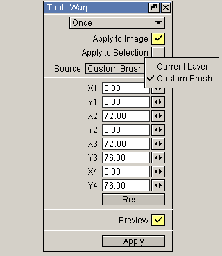

yeap, but what we need now is a Warp Tool option : a button to toggle Current Layer/Custom Brush,
- when set on Layer => what we have now ( 4 points editor),
- when set on Custom Brush => idem but applying on the brush (setting the 4 corners of the current brush)
("Apply to Image" and "Apply to Selection" ghosted when "Custom brush" selected) 8)

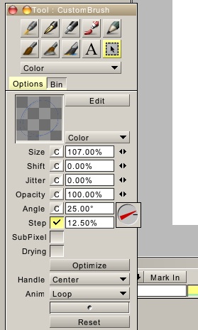

I have tried this , but am having difficulty with this technique used to "free transform" (as in Photoshop) part of a drawing; to resize or rotate part of the drawing selected with the Magic Wand tool .
When I select the part of the drawing which I want to resize and/or rotate, the selection does not stay stationary on screen when I move the mouse/stylus over to the custom brush Options panel to adjust the settings (for instance :change size from 100% to 107% and rotate the angle 25 degrees). When I move the mouse or stylus over to the Options the selected portion of my image moves off screen and I am unable to view it as I make the adjustments in the Options panel . It would be more helpful if the selected portion of the image would stay in view so I can make fine adjustments to the size and angle , so I can better judge exactly how much I want to adjust the size and angle .
Adjust Options.jpg (46.12 KiB) Viewed 53180 times

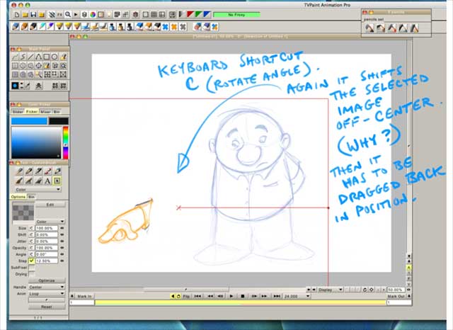

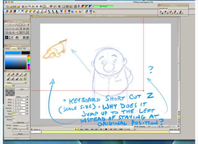

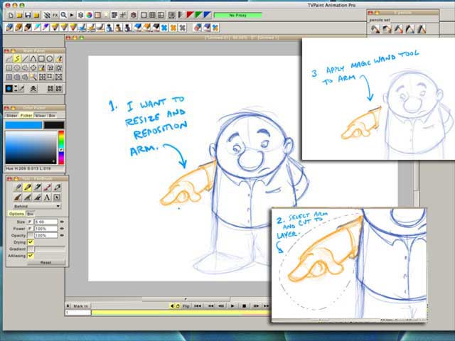

I'm still puzzled about why it's such a round-about process , instead of a simple free transform of the selection.
See attached images .
Let's say I want to slightly enlarge an arm and reposition it by rotating the angle a bit .
  • -I select the arm with the Select Tool and Cut To Layer.
    -Working on the new Layer for the arm I then select the arm with the Magic Wand tool .
    -Keyboard shortcut Z brings up a box which allows me to scale the arm up or down , but for some reason it shifts the arm over to the left , off-center from it's original position. I have to drag it back to the place I want it to be , then do the resize.
    -The same thing happens when I use Keyboard shortcut C to rotate the angle --- the arm is shifted over to the left and I have to manually drag it back to it's original position and then perform the rotation.
    -At this point I "stamp" the brush down in the new position and then merge the arm layer back on to the body layer .
Am I still doing it wrong ? This seems like a very long, round-about way of doing it. Almost seems faster to save out the image and open it in Photshop, do the Free Transform in Photoshop, then import it back to TVPaint to continue working on the scene.

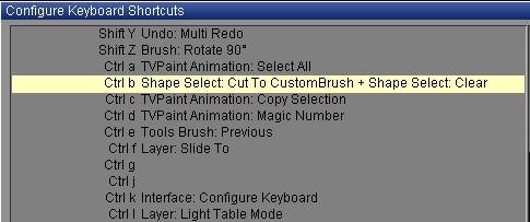

what I would do :
- "freehand select" the arm,
- Tool Select: Cut to Brush (or better: hit a shortkey, see pict.)
- then, press /, *, +, -, to rotate, size up/down your arm,
- left-click it at the right place.
edit: if the body stay still, while the arm is animated, draw it on a separate animlayer.
ZigOtto wrote:what I would do :

Thanks, ZigOtto. That , too , makes it much clearer.
I still wonder why the keyboard shortcuts Z and C using the Magic Wand tool make the image shift over to the left instead of staying in the original position ? This seems like something that could be fixed in the next release of TVPaint.
