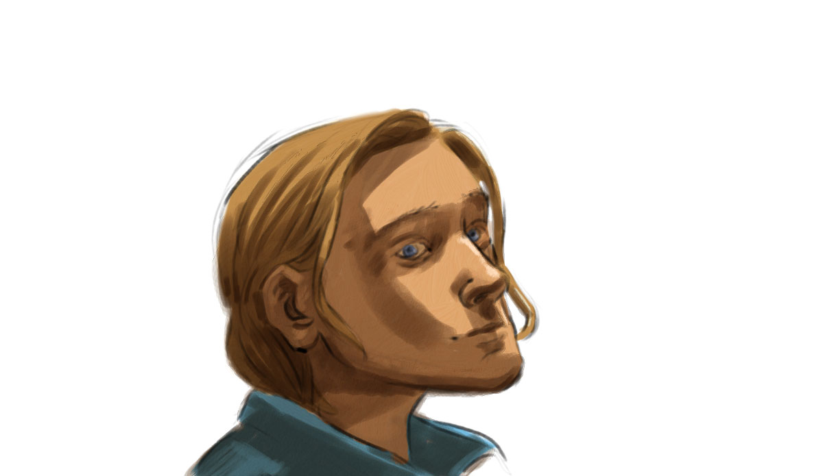

- paul15a-2.tvp
- This is how it looks like in tvpaint. I know that there is way to merge layers and multiply them, but I need immediate multiplication when I'm painting it.
- (1.57 MiB) Downloaded 1563 times
- This is the picture the way it should look like (unfortunately I couldn't upload a photoshop file incl. layers)
- paul15a-2.jpg (243.49 KiB) Viewed 38959 times
Dear Hisko,
Welcome on our forum and thank you for your your interest in our softwares.
The real-time layer blending is not possible yet, that's true.
Although please note that we already have our development plannings set for the future versions and you could have good surprises...

Hisko,
in the mean time, why don't you create the image in tvpaint, and use layer transparencies and brush transparencies to create the same look? between all users of tvpaint we have quite impressive brushes. I have tried a few times to paint in painter, but I always end up getting back to tvpaint, because I feel the brushes that I use fell more natural to me. If you're interested, I can send you some of the brushes I use.
but if you still prefer to create in photoshop/painter and then import it to tvpaint, there are a few ways of achieving the same look:
1. import all your frames from photoshop/painter, and then apply the multiply layer onto the colour layer with keyframer set on 'multiply'
-or-
2. drag the multiply layer icon onto the colour layer icon, and choose 'multiply' from the drop down menu of the pop up window.
-or-
3. apply the FX colour->Scan Cleaner to the whole of the multiply layer, which turns all white information in the layer to transparency. it then behaves like a normal multiply layer, and you can play with the layer opacity. I recommend to use this method if you import PSD files as frames.

Hi,
Thanks a lot for the replies. I have been too busy lately to respond.
Malcooning, I am interested in your brushes of course, so if you could send me some I would be very grateful. I am also curious about your artwork too.
The use of layertransparencies and brushtransparencies though is not a solution for me. I use opaque colors underneath my lines and then I really need a multiply-layer for the shadows, beacuse with a normal transparencymode, every time a brushstroke is stopped, the new brushstroke that overlaps will look darker and besides that, a dark brown shadow will make a black area look lighter instead of darker. I know there are other ways to achieve the effect that I want, but those work-arounds will take too much time for a fully animated realistic 15 minute film and they will affect my intuitive way of working too much (I want to see what I am painting the moment I'm painting it).
So actually I really do need a multiply-layer, and I hope that there will be a new version that has that feature (any news about that?).
