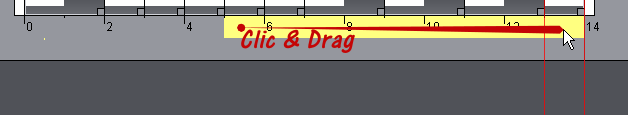

in the timeline, under the film-strip, LMB-clic (hold) & drag along the timeline to make your selection, from A to B or from B to A, as simple as that,

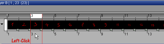

or alternatively, in 2 clics : clic 1 on the first frame of your selection, press Shift key and clic 2 on the last frame of your selection :
