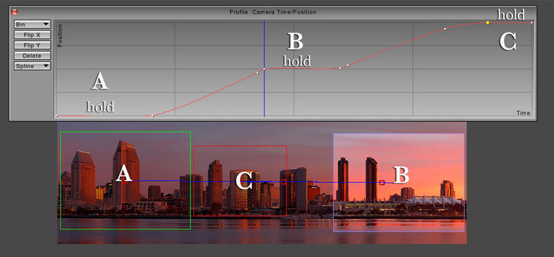

I think there is room for improving the Camera Tool , but it can in fact do camera movements from positions A - to - B- to - C , etc. , not only from A - to - B . The more moves within a single scene the more complicated it is and getting used to setting the "hold" points and the slow-ins/slow-outs can be tricky, but it can be done.
Here is a simple A - to - B - to - C move I did on a stock photo of a skyline (standing in as a "Pan BG" ) . This only took 5 minutes start to finish. There is no sophistication in the move , but simply for demonstration purposes to show how the hold points are set on the Profile Editor graph.

click anywhere on the path between the start and the end of the path, and you will generate an intermediate 3rd point,

[Edit] Thx David! I see two points here: so I have to open the profile editor first - does it not work with just ging to the keyframe in the normal timeline? And 5 minutes is still much longer than the maybe 1 or 2 in AS - I urge everybody to install their trial, don't just believe me.
