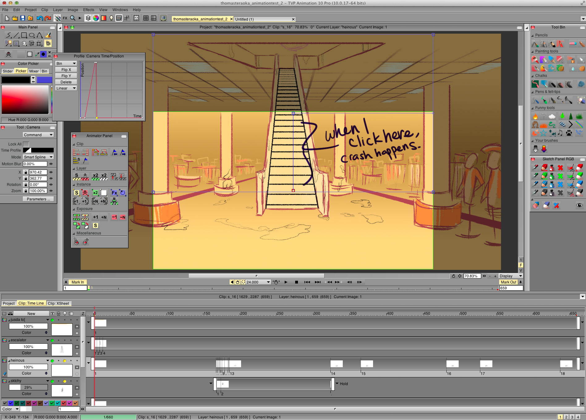

Hi there, I'm having camera problem: I worked on a scene with camera movement, I'm going back to it now after not touching it for a while. In the scene I'm trying to add another camera move-- but when I do, TVP crashes, every time, on different computers, even without anything else running. My clip is a camera movement panning to the top then back to the bottom... so my time profile goes all the way up and then back all the way down. Adding another camera point between the two points crashes TVP. Playback works fine. Does anyone have ideas for me?

Which version of TVP and which OS? It would also help if you could add a screen print of your Camera position Profile, including your camera Panel's settings.

Re: add Camera movement = TVP crash
oops sorry about that!
Mac OSX Lion, 10.7.5,
TVP PRO version 10.0.17- 64bit
I played around with Time profile settings, Tool settings, but what ultimately worked(!) is I deleted the camera points, and just re placed my camera points. The time profile was saved, and my shot was very simply a straight line, but I can imagine this more frustrating for a more complex pathway, to have to delete some intricate camera movement. Anyway, I'll keep checking to see if you guys find out anything, but this is no longer an issue for me
