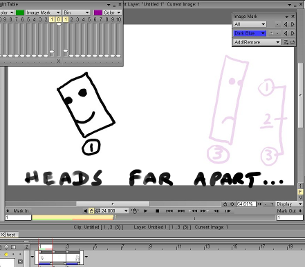

I'm exploring the awesome off pegs feature. I want to use it to inbetween elements in my drawings that are spaced far apart. I think that's the intended use (in addition to a pure place&trace). I have found the controls in the light table parameters for this, the boxes at the bottom that bring up the placement and rotation controls that I need for this. So far so good. I can now do a mechanical line-in the-middle inbetween, using the light box. At this point when working on paper I like to turn off the lightbox and just use light from top and flip the 3 drawings to fine tune volumes and line quality. In TVPaint I was hoping to be able to do the same, flip the drawings in this off-peg mode and keep the heads or hands or whatever I'm inbetweening basically in the same spot and flip using the left/right arrow keys and fine tune the drawing. This is an essential part of the off-pegs method. So far I have not figured out how to do this in TVPaint. Is it possible? Thanks!

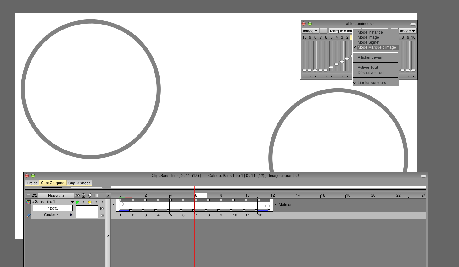

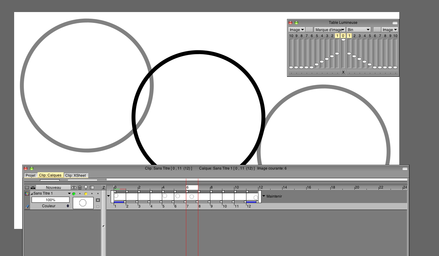

If I understood you well, I advise you to combine the out of pegs with the image mark panel.
With the image mark panel, mark the 2 key images that needs inbetweens, like this :
Then, active the light table and change the parameters : use only the previous and next image + change from "instance" to "image mark"
Now, you will have the possibility to flip between previous images, but you'll still see the marked images only in the light table

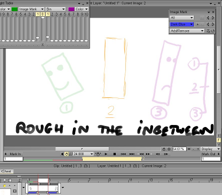

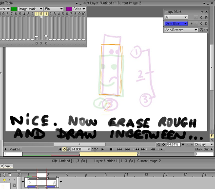

Merci Elodie! I like the marking feature, but it does not seem to solve the off peg flipping problem.

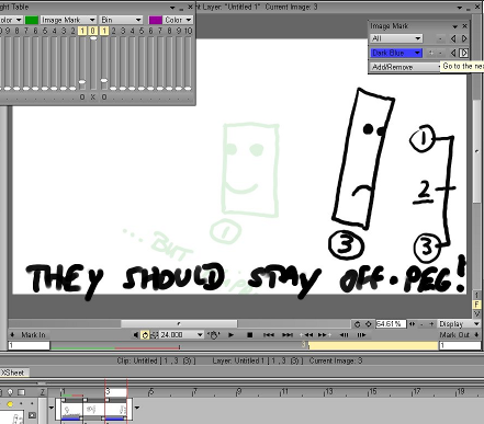

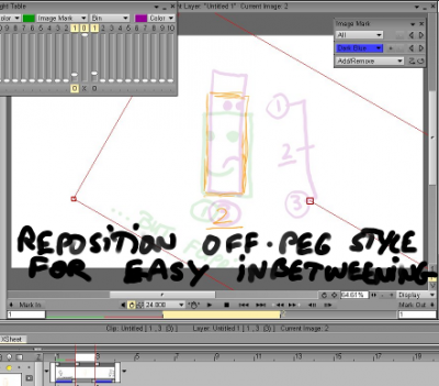

I hope these screengrabs will explain the problem. (I have to divide this into 3 replies because I can only attach 3 images at a time.)
- OffPeg01.png (80.76 KiB) Viewed 28347 times
- OffPeg02.png (82.65 KiB) Viewed 28347 times
- OffPeg03.png (89.88 KiB) Viewed 28347 times

Re: off pegs - how do I flip?

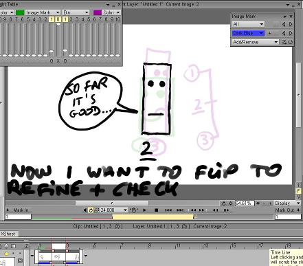

more screengrabs

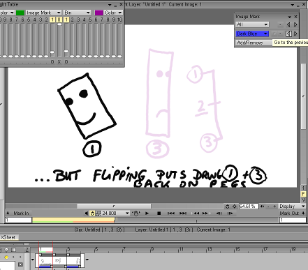

Final screengrabs. I hope there is a solution for this. Flipping the drawings while they are "taped down" off peg is a really important part of this method. You want to be able to finesse volumes and lines while the elements are basically on top of each other. If this is not possible yet it should be included as soon as possible. This feature is an important one that's available in TVP-Pro only (not in Standard). For me this could be a selling point if it would actually work. Thanks!
- OffPeg07.png (53.83 KiB) Viewed 28346 times
- OffPeg08.png (88.65 KiB) Viewed 28346 times

This function is going in the right direction. It stays off pegs and plays my above images for one time in off-peg mode in chronological order 1-2-3 whenever I press the hotkey. I like it at 4 frames per second. Very nice, but it doesn't quite emulate the way we do it with animation paper. I have some suggestions.
The typical inbetweening situation with paper using my above example drawings would be that you put drwg1 on your light box, then drwg3 and on top drwg2, which is the inbetween in progress. Now you would start drawing using the light box, but also light from top and you keep flipping back and forth between the drawings 1-2-3-2-1-2-3-2-1 etc.
Currently when I'm not using off-peg mode I can get close to this by using the left and right arrow keys, left-left-right-right-left-left-right-right etc.
The flipbook function we get with the W key is good when we animate straight ahead; it emulates rolling the drawings. When I'm inbetweening I much prefer manual flipping. I really like flipping between bookmarks or marked frames as Elodie described above, which emulates pulling certain drawings and working on them out of shooting order. I feel that all these ways of manual flipping should just work in off-peg mode.
In addition it might be worth trying to add additional options to the flipbook mode. I would like it if I could set it to Loop Back and Forth like in QT player. And keep on looping at the set speed (in my case 4fps) as long as I press the key. When I let go it would land on the current frame which is the inbetween I'm working on.
