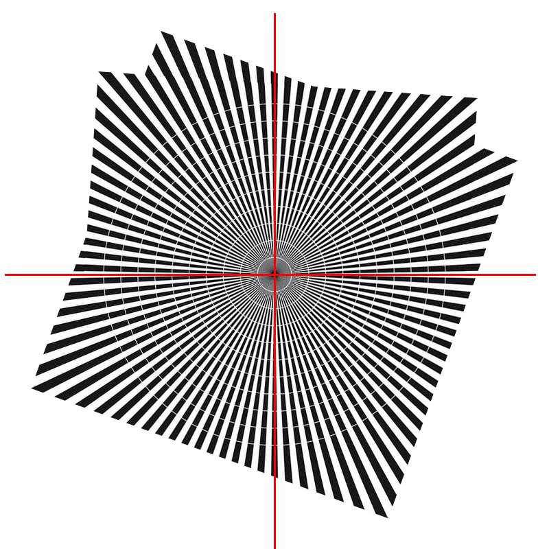

I used a Siemens star and rotated it 4° and 20° both in TVP and PS. Then I pasted it all together to form this image. Can you see which quarter is the result of which program? I can't.
Of course you will get successively worse results if you rotate the same image again and again again.
