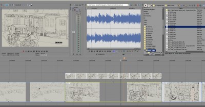

Re: Layer window zoom
I can zoom into a layer in Vegas and the screen print below shows what it looks like. I placed a copy of the same layer on top of itself; the top one being normal size, in which you can't see much of what each frame depicts but you can see the entire length of the clip.
Below that is the blown up layer, which shows a clear enough picture of what individual frames contain, except you can see only two of the frames out of the entire clip because, well, it's a zoom in.
At the top left is the project window, which shows a clear picture. So of course the zoomed in layer is useless if I am looking for a specific frame, and so is the zoomed out layer useless if I am hunting for a specific frame. Only by scrubbing across the layer can I really find the frame I am looking for in the project window, and this would apply to TVP the same way.
