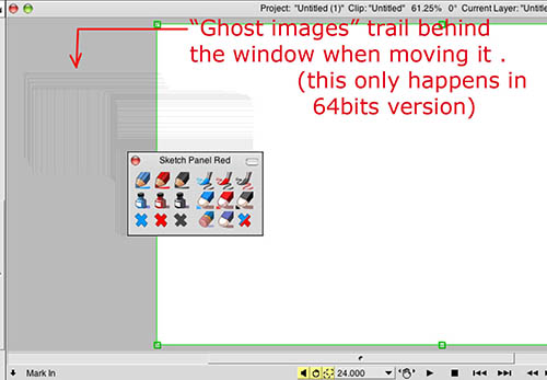

I just got a new Macbook Pro (15" Retina display) running OS 10.9 Mavericks. TVPaint 10.5.4 32bits and 64bits seem to be working fine for me , although in the 64bits version I sometimes notice a weird lag/refresh problem when moving a window. See the screen shot attached. When I move the panel it leaves a trail of "ghost images" behind it. Usually these ghost images disappear after a moment , but sometimes they stay on the screen until I adjust the size of the entire interface , then the ghost images disappear. A minor annoyance , but not a big problem . However , that's something that the development team should look at .

Indeed, I know about that, and the solution is to run TVPaint Animation on Low Resolution mode : cmd + i, then click on the "Low resolution mode" (don't really know the exact name, as I don't have a Retina here). It is not a Mavericks-related issue, but an issue with the Retina displays themselves (it would be the same with a Retina using Lion or Mountain Lion).
I also know how to fix it so you don't have to be on "Low Resolution mode", but applying it requires the use of an Apple function that appeared with 10.7 and works only on 10.7 or later, and as we still have a 10.6.8 compatibility, this is not an easy task.
So, for now, the only option is to use the low resolution mode.

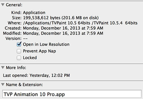

Thierry wrote:Indeed, I know about that, and the solution is to run TVPaint Animation on Low Resolution mode : cmd + i, then click on the "Low resolution mode" (don't really know the exact name, as I don't have a Retina here). It is not a Mavericks-related issue, but an issue with the Retina displays themselves (it would be the same with a Retina using Lion or Mountain Lion).
Ok, thanks. Now I see it in the Get Info window.

As it is now the lagging ghost images are not a big problem , but as I said previously just a minor annoyance . I can get along with it , but if there's a fix which doesn't require starting up 64bits in Low Res mode I'd prefer to try that .

D.T. Nethery wrote:I would be interested to know more about the other option to fix it without using Low Resolution mode.
It's not something that the user can do, but something that must be done in TVPaint's code : using a function provided by Apple that only works on OS X 10.7 or later (as the Retina display screens appeared when 10.7 was the current OS). However, we still support OS X 10.6.8, so we can't use it.
We could abandon 10.6.8 support so the Retina issue would be solved very quickly, but there's too many people that still use this OS (it's like Windows XP, there is still a lot of people that use it)
