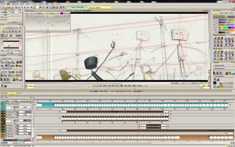

Also, I have a couple of interface screenshots.

here are the screenshots.
please be patient about the question though, the email need to be translated, answered, translated again, etc ...

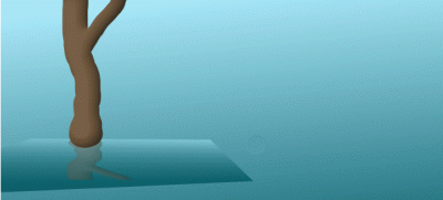

Here's a side by side example. To the right, the original ripple, to the left, it laid down in perspective with some added effects.
Excuse my jumpy tree.. done in a rush to get out the door..
With TVP, I always like the simple approach. Here's a little quick animation done by doing fx / distotion / tornado on a gradient background..
Picked up and tilted with the fx / motion / keyframer. The little branch quickly painted on another layer, then that layer duplicated, flipped, placed underneath, and made partially transparent.
Then a little white hand painted raindrop added on a layer on top of everything else. Perhaps a similar technique was used on a much larger scale, and placed to fit into the scenes here..
Just a wild guess, but it's one of the ways I might go about it..

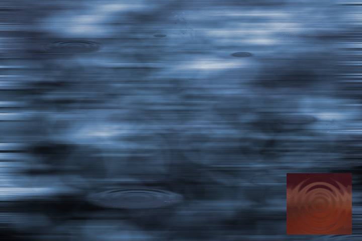

I have no idea how the drop/ripples were done but here is a variation on CartoonMonkey's post using the FX/Distortion/Wave effect (inset), then hand modified and squashed into an animbrush. Then scaled and stamped a few times onto a background, with drips and rain animbrushes added after.
(click to see 40 frame GIF loop, sorry its so big
It looks to me like the Raintown effect might actually be some kind of 3D plugin and I'd be curious to hear how it was done too.
