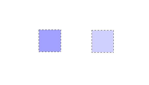

Something like this.
This layer has 2 squares. Left is R255 G0 B0 A255.Right is R255 G0 B0 A150
I want to change it like this. Left is R0 G0 B255 A 255.Right is R0 G0 B255 A150
And I want to make a selection area that keeps opacity from a layer.
Are there any functions like photoshop's "select pixels" in TVPaint?
I want to make a selection area from a layer like this.
Left selection's alpha is 255 but right selections's alpha is 150.

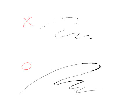

Last question will be clear with this picture. Please see this.
I draw a line using PenBrush stroke size1.00, size pen pressure on and no Antialiasing. It get something like upper one if I draw it softly.
I want to draw lines like below that keeps minimum 1 pixel width. It is possible in Photoshop.

Two keywords: Stencil and Preserve Alpha. Read about these in the manual, play around with them, use them. (Questions 1 - 3)

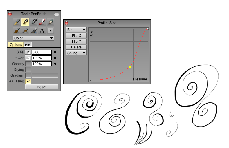

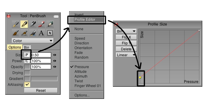

To complete Slowtiger's words :
profile editor.jpg (86.94 KiB) Viewed 27036 times

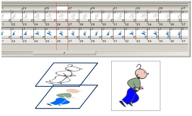

When Slowtiger mentions : "most of us colour their animation on a separate layer." Here is a picture to show what he means (illustration from user manual , Lesson 6 ) =
TVP Color On Layer BELOW Line Art.jpg (78.34 KiB) Viewed 26997 times
The advantage to having the color on a separate layer below the line art is that you can easily change the color of the fill layer under the lines , or change the color the lines on top of the fill layer underneath.

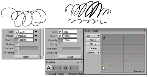

If you want a continuous non-antialiased line, DON'T use pressure sensitivity for SIZE. Instead, set the set SIZE to NONE [C] and, while you're at it, set the size value to .75. You should get a continuous, single pixel width, jaggy line without breaks.
If you want continuous non-antialiased variable size jaggy line, USE pressure sensitivity for SIZE [P] and enter some max size value, but also (as Elodie suggests) set the PROFILE for SIZE... but start the curve above zero on the Y axis.
aliased lines in TVPaint.png (58.16 KiB) Viewed 26936 times
