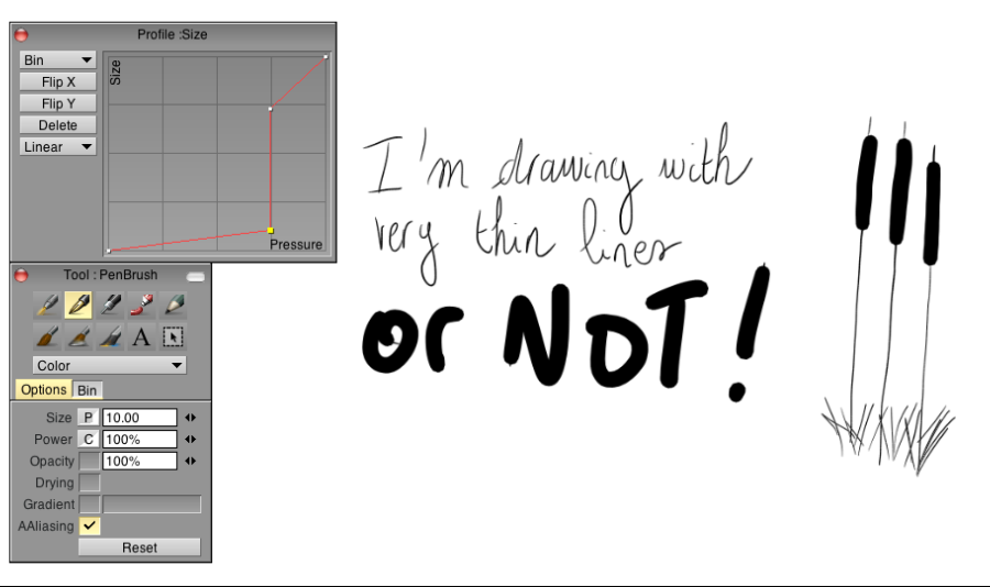

I was in a studio on last Friday and a young animator told me very clever trick (Never thought about it !) : playing with Edit Profile on the Size, with the Pressure on.
Then, you just need to switch between Erase and Color mode.

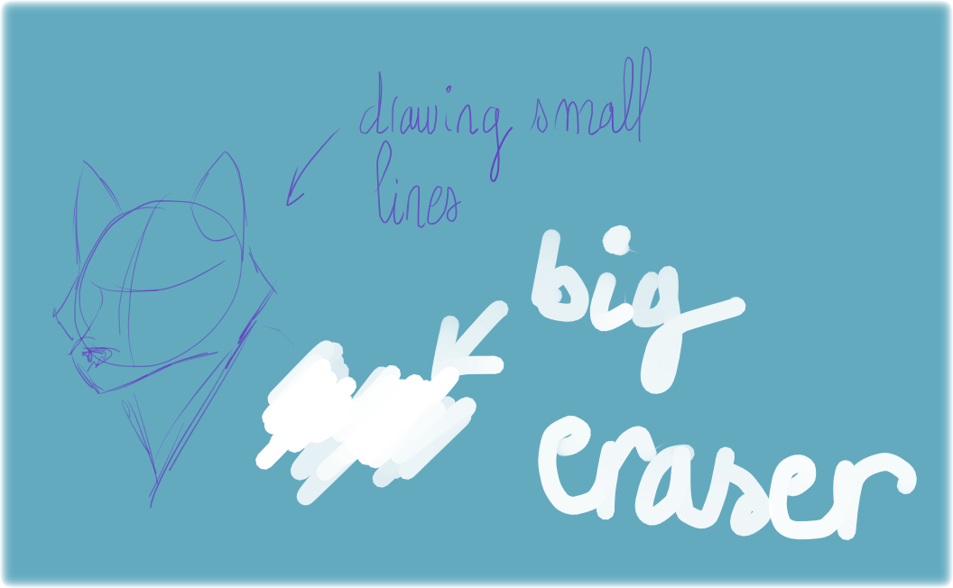

Currently, if you create a tool and switch between F2 / F4 (color / erase mode), the brush style has the same size. Some people want the eraser bigger than the drawing tool.Paul Fierlinger wrote:I don't get it. Yes, I see (and I've tested) how you can draw between two extremes, if that is what you need and like to do-- extreme thin and extreme thick with nothing in between. But what's so different about erasing? It's always been that way, that you can select between color and erase.
With this kind of brush above, you have immediately a strong and big eraser, just by drawing a little harder than you usually do :
